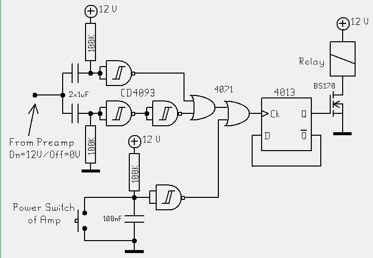

I have just finished building a 5 x 100W amplifier based on the OMP MF100 amplifier module from BK Electronics. I would like to add a circuit to power up the amp from a remote 12V trigger from my preamp. Is this something that is easily done? Has anyone designed a circuit to accomplish this?
Gabe
Depends if the 12 V are only a pulse or a constant level as long as the preamp is powered on. But in both cases, you should use a D flip flop to drive a relay.
The little schematic I attached shows you an ubiquitous circuit. The main switch is a tactile one, it just relies on the relay to power any load, as heavy as you want. The remote assumes you have a constant level when preamp is on, thus a little differenciator performs the switch on/off work.
If you have a 12V pulse instead, when preamp goes on and when it goes down, just remove the differentiator and drive directly the OR input with the pulse.
Hope this helps

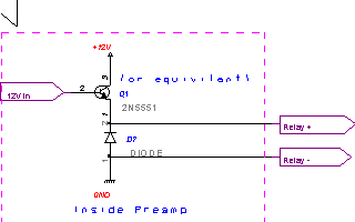

Since a 12V source is unlikely to exist inside the power amp, the circuit seems a little overkill. Assuming the 12V will be high when the preamp is on, low when off, direct coupling to the relay would be a much easier and less time consuming option.
If the relay needs too much current, a simple BJT or MOSFET follower can be installed in the pre-amp, so 12V power is not needed in the power amp.
