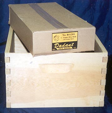

Hand Selected Ponderosa Pine from the Northwest, the best wood for the job .......
Paul,
One of my first speakers were made from bee hive boxes that I nicked from the old mans garage when he was not looking........
I screwed a chipboard panel front and rear, and mounted a Foster 12" 3 way setup - sealed infinite bafle.
With the right amount (a fair bit really) of internal damping (fibreglass ceiling batts), these things really cranked and were in demand for heaps of parties back in my younger days.
These $15.00 instant boxes are available easily as kits, are precision cut and require minimal finishing.
Carton of 1 Hive Body. Select: A grade that is truly "selected" which allows only very small tight knots and no deviations in the joints, rabbets, or hand holds. Our woodenware is manufactured from hand selected ponderosa pine. Each board has been carefully moisture-metered to assure its proper moisture content before it is precision milled into the finished product. All our hive bodies have "pre-drilled" holes for nails to prevent splitting during assembly. Handholds are taper cut for easy gripping - Moisture Metered before cutting to prevent warping - Uniform Interlocking Joints for strength - Ponderosa Pine from the Northwest, the best wood for the job - Uniform Frame Rests provides the proper "Bee Space" - Nails included, not assembled.
The rabetted finger joints are infinitely strong when glued and/or screwed (lots of screws).
The handhold cutouts are really handy when loading into and out of parties but the panels can be turned inside out.
Real wood panels do not have to sound bad, and these ones certainly didn't.
