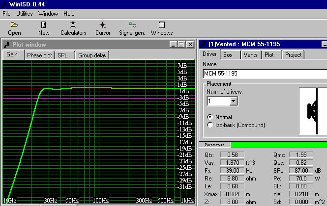

Anyway. I am very interested in building the small El-Pipe-O with 8" drivers. The only driver I can find locally (from the Farnell agents - Mantech) , is the MCM #55-1195.
1) Will this driver do a good job for this design?
2) Will Aleph30 be able to drive enough to do the job?
Thanx for all.
See WinISD info:
You might try some 8 inch diameter tubing at a length
which goes to about 6 inches from your ceiling (assuming you
have an ordinary ceiling). I did one with a Vifa 8" and was
very pleased with the result. The curve, of course, will not
resemble yours very much, but it will kick butt.
An Aleph 30 will do the job if the butt to be kicked is
ordinary size.
The Qts is in the right ballpark. Now that Rick Shultz's alphaTL article is out in AudioXpress (and hopefully soon on my web site) you can just plug the numbers into his scheme and end up with an optimum El Pipe-o... a little late for me to run the numbers but i could maybe do it tomorrow.
dave

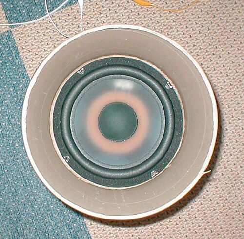

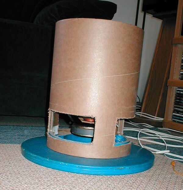

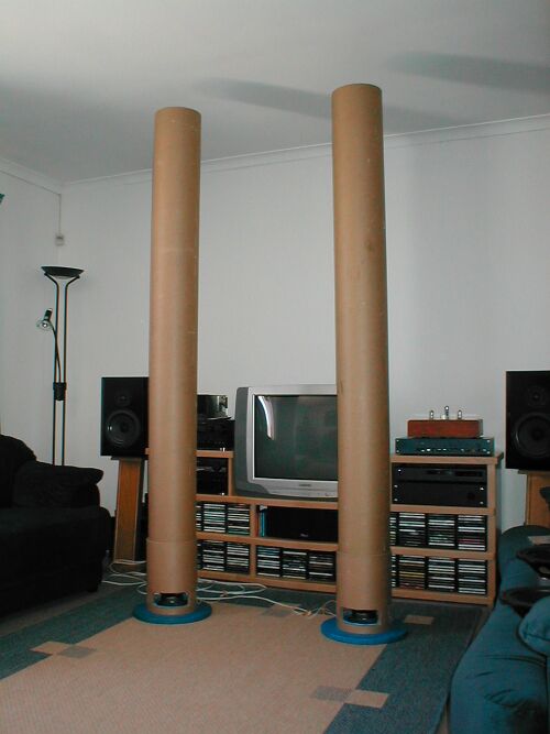

El-Pipe-Mino progress
I eventually got some 8" drivers and my pipes. Build them this morning but not enough time to test, work afternoon shift. The 2 drivers which I am going to test are:
................................P..Qts..Vas..fs
1) MCM 55-1190... 70W 0.54 2.3 31Hz
2) MCM 55-1240... 45 0.74 2.2 37
For 1) my pipe length must be 2.4m and for 2) about 2m. The 2.4m is abit high for my ceiling, so will use 2m in both cases. Will have to listen to results for an opinion if this will work good enough. I used a 8" paper pipe and bobben (spool) used for stitching wire on book press. The pipe fit just snuggly into bobben and the bobben's side end, acts as a good stable foot for the pipe.
Here are some pics for now:

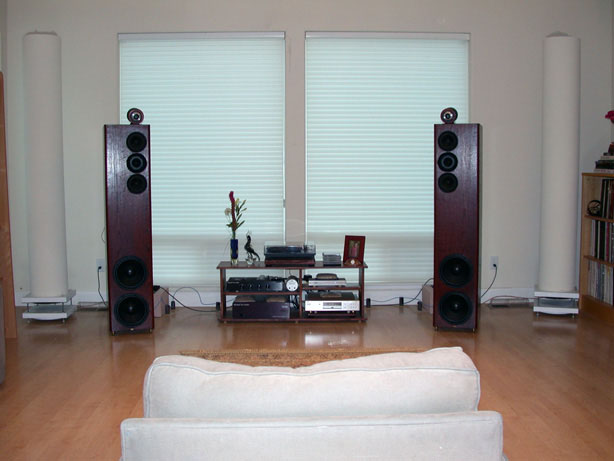

Hi Nelson and others
Could anyone tell me what length of 12" sonotube I would need to build an El Pipo with my Shiva Mark IV? If I understand correctly, since Shiva has an Fs of about 21Hz, I would need a 13 foot long pipe to be at 1/4 wavelength. I have already built a stereo pair of T-lines shown below, but they are only about 7 feet long. Can anyone tell me how to calculate what the response should be with that length?
Chris
Greets!
FWIW, for audio purposes altitude per se has no bearing on the SoS, it's the temp changes that affects it, and unless you keep your house fairly cool the SoS is closer to ~13,560".
Also, pipes have end correction factors based on the boundary conditions of the terminus, so for a ~free space loading 12" i.d. pipe like the 'El Pipe O' you would add 6"*0.613 = 3.678" to 84" to get it closer to correct, or ~38.66 Hz, though if the driver is in a box there's another end correction that will further lower it.
