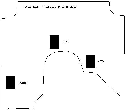

Having troubble reading some discs and after reading all the good advice in this thread here I have come to the conclution it might be necessary to up the laser output a bit.
The problem is the PCB in the CDM-1 is another version than showed in my service manual (Marantz CD73). The one showed in the manual has 2 pots and the one in my player got 3. Now I don't know which adjusts the laser output.
If anyone could tell me which pot it is I'd be verry happy. Also, which version is the 'newer' one?
I have drawn an outline of the PCB with the placement of the pots to make explaining easier.

Hello Thomas,
As I was "involved" in the development of this CDM I hope I can help you a bit.
The 47k potmeter is FOCUS OFFSET
The 2k2 potmeter is FOCUS GAIN
The 6k8 potmeter is LASER OUTPUT
The 6k8 potmeter differs depending on the used laserdiode. (in my docs it is 1k Ohm.
The Pcb shape you draw sugest a CDM-0 Pcb. CDM-1 Pcb's are more "squarish". I can imagine that Marantz used slightly different parts.
Be carefull with "adjustments". FOCUS OFFSET is indeed an adjustment. You have to set it correct, otherwise it influences the overall performance negatively. The FOCUS GAIN influences the "playability" behaviour. This a compromise. The tightness of this servoloop determines very much how a well a disc plays. Depending on the sort of errors that can occur on CD's the "best' adjustment can be a bit different. So this adjustment is indeed a compromise.The LASER OUTPUT determines indeed the power of the laser. Here simply enough is enough. There is no reason to shorten the lifespan of the laser with a StarWars "lightsaber" approach. 🙂
I sugest you contact the local service organisation for the correct servicedoc and servicedisc. I am affraid that the needed service disc is a bit pricy. On the other hand a CDM-1 was developped when there was not to much knowledge about disc behaviour, so it is a bit more muscular as you see today. It might be worthwhile.
I hope I helped you!

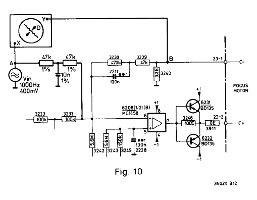

The alignment should be done in the following order:
1. Adjusting the laser current
2. Adjusting the height of the disc
3. Radial offset alignment
4. Radial control power amplifier adjustment (in service mode)
To adjust No.3, set the rig as on the attached picture and play a CD with no errors. You will want to obtain the minimum amplitude modulation with the trimpot 3158 on PREAMPL+LASER BOARD.

I think that you are looking for "radial offset" and that the "focus offset" refers specifically to the voltage offset on the focus motor driver output between no-disc and reference disc values.
The universal way of setting the radial offset on Philips CD304-based machines is without the jig on the above image. Basically you will want to trigger the oscilloscope with 650Hz fed into radial mechanism, probe between the output of the RF amplifier circuit on CD drive board and ground and again adjust for the minimum amplitude modulation.
My apologies, there is a bit of confusion among different terminologies used by different manufacturers. The sequence of alignment I described applies to CDM1-based players using more modern TDA servo circuits where the FO trimpot is not even present. The two adjustments I suggested are actually for the focus gain. However, two SMs I checked explicitly say "factory aligned, not to be changed” for the FO, while the common wisdom is to leave the trimpot in its original position or, if moved or trimpot changed, to place it in the middle position.
The adjustment of the radial motor offset voltage is done in the service mode. Basic adjustment is to place the swing arm in the middle position and correct the voltage on radial motor driver output to minimum. This is done in the service mode. There are several programme steps in which the symmetrical inward and outward deflection of swing arm is observed (it also serves to compensate for the spring-loaded resistance of the flat cable). The last programme engages the player in PLAY and the arm follows the track but without the processor.
