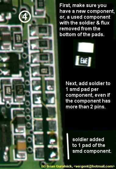

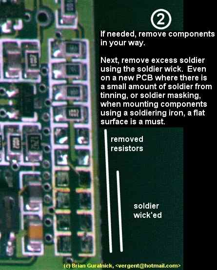

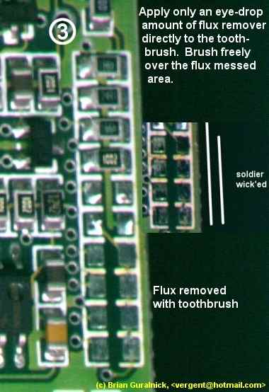

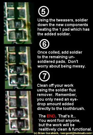

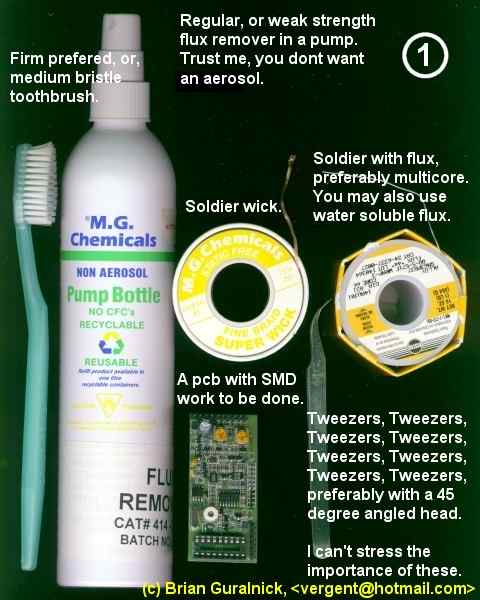

Easy-Cheap-DIY-SMD mounting guide.
A little something I threw together.
NOTE: The cheap Radio Scrap Iron is as a second to be used with your main 1 for heating the SMD component from both sides simultaneously. This is ONLY to aid in removing many components. It is not used for assembly.
