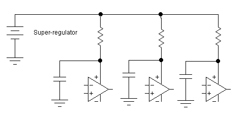

After building super regulator we connect it to several opamp via RC filters to prevent possible loops. The individual supply to each opamp will have source resistance R in parallel with C, now C value and it type again become significant. How should one choose R and C values? Should R be replaced by inductor? I feel that using super regulator for each opamp is too much.

dimitri, I would have chosen 10-100 ohms + 47-470 uF// 100nF/63 polyster/ceramic. This I think is a good compromise for some isolation between the opamps. This is also good thinking.
Use 100 ohms to start with. Lower the value if you feel that you get to much voltage drops. Less than 10 ohms the isolation effect become rather small.
