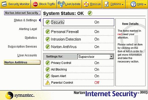

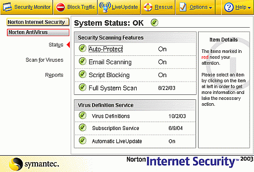

PS: Just to repeat what Rudolf said, if you have Norton AV don't forget to diable "scripting" individually when running this. for some reason, disabling Norton AV completely does not appear to do the trick. To disable "scripting" individually seems to be necessary.
I disabled norton and reinstalled mathcad, but still nothing!
This is all I get:
It acts as if it is nothing more than a help file, nothing opens up, nothing changes when I try to open the downloaded files like TL Closed End.mcd
:bawling:
Thanks for your help guys. Anyone got any other ideas? Is there something I'm missing?
cheers,
Paul
That is precisely what happened to me over the course of many attempts and several days.
Not to go overboard, I just want to make sure that you did not not simply disable Norton entirely, but actually go into defeating the script blocking. Defeating the script blocking individually seems to be very important.
Not to belabor the point, or try to drag it out, but you should first click on the Norton icon on your desktop or system tray to see the following screen:
Then you should click on "Norton Antivirus" on the left side of the picture, (highlighted in yellow), until you see the screen below.
Then just disable the script blocking.
Also, even after doing all that, I find that the first click on Martin King's worksheets results in an error message. but if I click on it again, it comes up. Other people with the Norton situation have said the same thing on this board.
Let us know how you make out on this.
