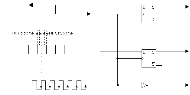

Reclocking is a very good thing, with a few subtlties here: One cannot register/reclock the bitclock and data lines with a 256fs clock, so the BB 1700/1702/1704, which updates iout on a rising edge of bit_clock after a falling edge of latch_enable, preclude(s) true reclocking at the DAC unless one uses a 512fs clock and divides down to feed the transport.

There is no reason why you can't reclock a bit clock running at 256fs with a low jitter 256fs Master clock. You just run the data, bit clock and word clock through some D flip flops which are clocked with the 256fs Master Clock.
The critical thing is to watch the timing at the D flip flops clock in relation to the data inputs.
To get around this I was thinking about using a small FIFO say 16 words by 4 bits in place of the D flip flop. See the "Jitter in DAC" thread for more info on this.

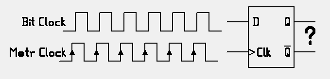

I surely miss something ...
Excuse me Sirs, but there's something I don't understand - I surely miss something obvious. How can you sample a signal at the sampling frequency ?
It also important to note that the timing of the master clock in relation to the data is important so that the setup (and possibly the hold time) of the flip flop remain correct.
Also note that this is only required by the PCM63 as they require a low jitter Word Clock. The PCM1704 on the other hand requires a low jitter bit clock and if the above timing conditions are met then it should be possible to just connect the master clock straight into the bit clock pin and leave out the f/fs altogether.
