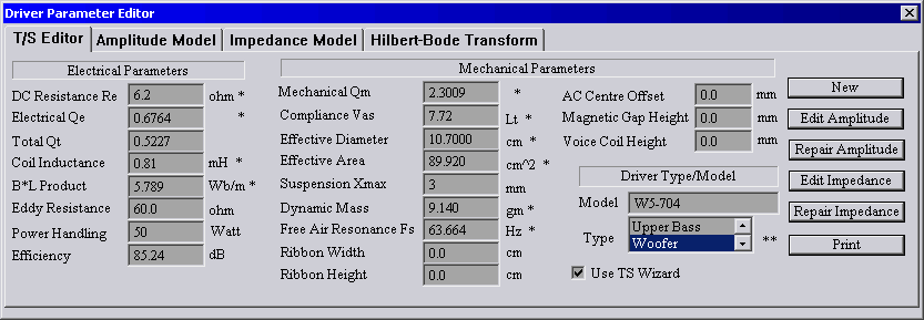

Thinking about using this speaker in a ~10L sealed enclosure.
Anyone used this driver before, any comments, reviews, or even testing data?

I'd put this driver in a 21.5L vented inclosure tuned to 43HZ. I will give you much better low end. I would also cross this thing pretty high. its flat out to about 5.5k. Id cross it at about 5k 1st order series to a 28-847S... but thats just me.

You're right, that alignment would be better, however I already have my enclosures and they are roughly 10-11L (spherical clay pots)
Not sure if I'm better off trying to find a driver that's comfortable in a 10L vented than 10L sealed. Then again, someone mentioned to me that venting a spherical enclosure wasn't a good idea.

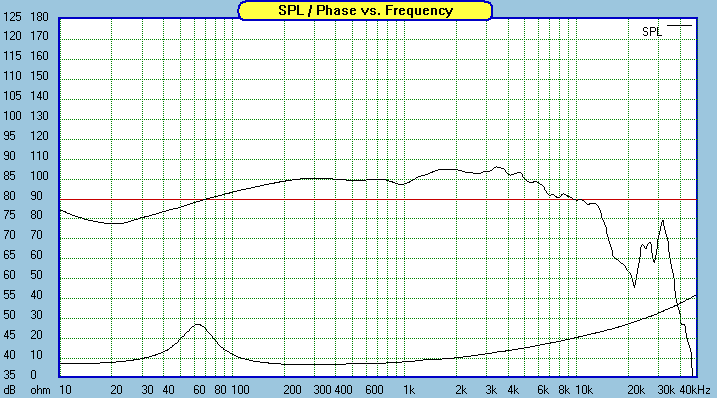

I have a pair of these on hand and I'll be testing them soon. I'll have the results on my web page shortly.
I've previously tested them and they looked decent. Here's my measured T/S parameters. We'll see how my current pair compares.
Frequency response, infinite baffle, 1w,1m.

It is an interesting looking driver, looking forward to your testing results.
