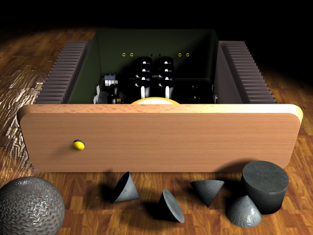

Here is mine
Here is my elector amp, oh and the 4 channel pre-amp i made:
it has 4*22,000uF rifa's
500W transformer
500W transformer

Nice amp, Helix.
