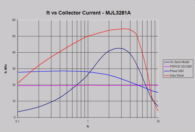

Well, I finally got done with a preliminary evaluation of several SPICE models for the MJL3281A and MJL1302A to compare their simulated performance, mainly of ft vs collector current, with the data sheet values. This all started a while back when I was looking at the simulated performance of a power amplifier with a capacitive load of 2 uF in parallel with 8 Ohms using these devices for the output stage. I was trying to see if I could get the thing stable for this load with no output inductor. It turned out that the simulated open-loop output inductance of the amp was so large that a major resonance occurred at about 100 kHz, preventing stability from being achieved with any reasonable unity loop gain frequency with the capacitive load. In a previous thread involving Fred and myself (which I can't seem to locate at the moment), it became apparent that the models he was using with his simulator and the models I was using, provided by On Semiconductor, were quite different. We got very different results for the output inductance using the same test circuit.
This subject came up again in the thread about the amp in the Randy Slone book. But seeing that Randy Slone thread title keep coming up again and again made me feel like giving Randy a break - and the discussion of models really didn't have anything to do with the original thread topic anyway. So I thought I'd post the results of my evaluation in a new thread specifically about the SPICE models for these devices. My main purpose is to end up with a modified model whose simulated output inductance will be as close as possible to that of the real devices, assuming the real devices match up with the data sheet. Actually, I'd like as many of the parameters to match up as closely as possible with reality, but I'm starting with ft vs frequency. The desire to compare simulated and data sheet ft values came from the following site: http://www.reed-electronics.com/ednmag/archives/1996/042596/09df3.htm. There they have an expression for the output inductance of an emitter follower as follows:
Lout = R / (2 * pi * ft)
where R is the internal plus external base resistance. This clearly shows the need for accurate ft in the model to get accurate output inductance. I'll also look at the internal base resistance, but that will be the topic of another post to this thread. I have three models for each of the NPN and PNP devices: the On Semiconductor models, the PSpice models for the Toshiba 2SC3281 and 2SA1302, and the models Fred posted in the thread I referred to earlier. I'm not sure if Fred's models were for the Toshiba or On Semiconductor devices though.
The simulation test circuits for ft are similar to those shown in http://www.diyaudio.com/forums/showthread.php?postid=235089#post235089, except that I put the DC supply in the base instead of the emitter (to keep a constant Vce) and set the collector supply to 10Vdc to match the value used in the ft vs Ic plots in the data sheets. I temporarily placed a current source in the emitter to set the currents to the desired values, then determined Vbe. Then I used these Vbe values to set the currents when doing the actual ft simulation. The result is a spreadsheet with two plots and the raw data. So without further ado, here is a plot for ft vs collector current for the MJL3281A.

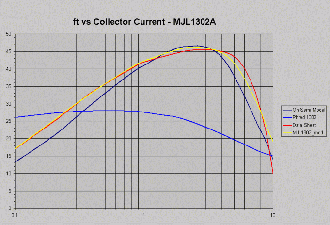

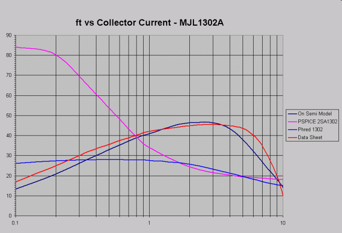

...and below is a plot for ft vs Ic of the MJL1302A. Clearly, the models for the MJL3281A are all pretty far off from reality, though the new On Semiconductor model for the MJL1302A looks at least reasonable. For small-signal analysis, the ft value for Ic of 100 mA is probably the most important. For the MJL3281A at 100 mA, the On Semiconductor model is more than a factor of six low for ft. So this says if the model can be tweaked to get this right, my previous estimates of power amp performance with a capacitive load will have been shown to be very pessimistic. This weekend I'm going to play around with the parameters of the On Semiconductor models in an attempt to get the plots to match up with the data sheets as closely as possible. I'll keep y'all posted on what happens. I'm going to try to fix the DC parameters first, then go for ft vs current. I'll also have a look at the internal base resistance if time allows.
Well, I don't know why all this ON-bashing, but to me the ON- models are way closer to the data sheet then any of the other ones. Since the data sheets are generated by actually characterizing the "average" device that is my reference.
The Pspice models clearly are a joke. Any decent text on semiconductor physics will show at least the general shape as shown by the ON-models.
Jan Didden
Our resident simulation "expert" (Phred) has told me countless times that the PSpice models are dreck. If what is here is typical, perhaps he is right.
Yes, the ON model looks like what one would expect, even if the data sheet said elsewise.
As for ON in general, I suspect that they are as good now as the Toshibas. I just find it hard to believe that they are "way better", as some claim.
Jocko
Great work Andy....cheers :nod:

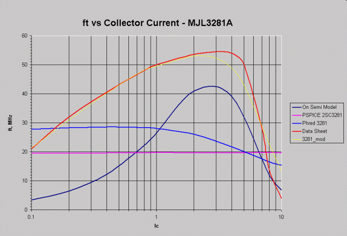

Tweaked MJL3281A model
Here's an update of the model tweaking. I adjusted the CJE, TF, XTF and ITF parameters of the On Semiconductor MJL3281A model to get the ft vs Ic curve to be as close as possible to the data sheet. I wasn't able to emulate the very sharp dropoff of ft at high currents, so the best I could do was split the error. This makes the ft start dropping off at lower currents than the data sheet, yet the final ft value at the highest current is larger than the data sheet value. However, it's possible to get very good agreement with the data sheet in the low-current region by tweaking only CJE and TF. The final model is included below. I've also included a new plot of ft vs Ic that includes this modified model. The modified model is the yellow trace. Next step is to do a similar thing for the MJL1302A.
.MODEL Qmjl3281a_mod npn
+IS=6.5498e-11 BF=139.247 NF=1.00176 VAF=46.776
+IKF=10 ISE=7.75232e-12 NE=3.34341 BR=4.98985
+NR=1.09511 VAR=4.32026 IKR=4.37516 ISC=3.25e-13
+NC=3.96875 RB=11.988 IRB=0.111742 RBM=0.102914
+RE=0.00127227 RC=0.209833 XTB=0.115253 XTI=1.03146
+EG=1.11986 CJE=1.0531e-08 VJE=0.4 MJE=0.450375
+TF=2.6464e-9 XTF=1000 VTF=2.06045 ITF=175
+CJC=5e-10 VJC=0.4 MJC=0.85 XCJC=0.959922
+FC=0.1 CJS=0 VJS=0.75 MJS=0.5
+TR=1e-07 PTF=0 KF=0 AF=1
Reactions: tschrama

Modified MJL1302A model
Here's the modified MJL1302A model as I mentioned I'd do. I used a similar approach to the MJL3281A model mods, adjusting CJE, TF and ITF to try to match the data sheet's ft vs Ic as closely as possible. As you can see, the original On Semiconductor models were already pretty close. The new model is the yellow trace and the data sheet values are the red trace. I got rid of the PSPICE model, as it was so bad that it messed up the graph scaling. This is really a minor tweak, but it may be of interest, especially to those trying to get the most accurate small-signal model possible.
.MODEL Qmjl1302a_mod pnp
+IS=3.25053e-12 BF=60.3363 NF=0.992063 VAF=19.8199
+IKF=7.18352 ISE=3.25712e-12 NE=3.42487 BR=5.15499
+NR=1.03617 VAR=2.77936 IKR=9.38159 ISC=2.5e-13
+NC=3.89405 RB=0.776136 IRB=0.0998107 RBM=0.776136
+RE=0.000613663 RC=0.0424163 XTB=1.43773 XTI=1
+EG=1.05 CJE=1.0690e-08 VJE=0.728073 MJE=0.42161
+TF=2.9458e-9e-09 XTF=1000 VTF=4.11586 ITF=380
+CJC=1.79861e-09 VJC=0.814822 MJC=0.473271 XCJC=1
+FC=0.8 CJS=0 VJS=0.75 MJS=0.5
Reactions: tschrama

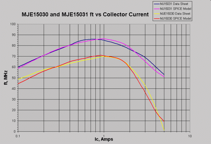

Here is some MJE15030/31 data
I had a look at the MJE15030 and MJE15031 models as well, with the thought that I'd have to tweak those too. It turns out that the ft vs Ic of these models agrees quite well with the data sheet curves of same.
One thing that I found interesting was the rolloff of ft at high currents for the NPN device is much more abrupt than for the PNP. The SPICE model tracks this sudden change quite well. But the model for the MJL3281A did not compare nearly as well to its data sheet rolloff of ft at high currents, despite my having made numerous attempts to tweak this. What's going on here?
Thinking about this question made me realize something I hadn't thought of previously. The parameter I was using to adjust the falloff of ft at high currents is called IKF. This interacts with another parameter, TF (the forward transit time). For a "semi-ideal" transistor, the ft increases with current at low currents, then becomes approximately constant at a certain current level, reaching a maximum value of 1/(2*pi*TF). Now the purpose of IKF is to make the forward transit time a function of current, rather than just being equal to TF. This then causes ft to drop off again at high currents. So in a nutshell, by tweaking IKF, one can adjust the rolloff of ft at high currents. But what does this really do? Well, it only adjusts the bandwidth of hFE. The rolloff of ft at high current is also influenced by the decrease of the low-frequency value of hFE at high currents (since ft is the product of the low-frequency hFE and the -3 dB bandwidth of hFE). This effect is dealt with strictly by the transistor DC parameters. So suppose the vendor didn't accurately model the falloff of DC beta at high currents. Guess what, the ft falloff at high currents will never be right either, no matter how you tweak IKF.
So I suspect that the inaccurate modeling of the falloff of ft at high currents for the MJL3281A is due to inaccurate modeling of the falloff of DC beta at high currents. But unfortunately I didn't check that. I assumed they couldn't possibly get the DC stuff wrong. Sigh.
At any rate, users of the On Semiconductor models for the MJE15030 and MJE15031 needing accurate modeling of ft vs Ic can be confident that the models predict this variation quite accurately out of the box.
Reactions: tschrama
