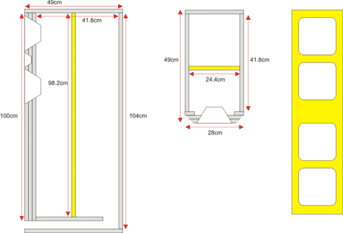

I would not put it exactly in the middle of the box. Put it at 3/5 or 4/7. This makes the reconance of the part in front of the brace different from the part behind the brace.
I would be inclined not to brace top to bottom, as these are the most rigid panels. The baffle will be the weakest, especially between the woofers. I would suggest a similar MDF arrangement to yours but front-to-back, one between the woofers (with cutout around the tweeter) and another one lower down. A brace can also be run between the lower crossbrace and the upper port to support this.

Why not place it diagonally. I mean from bottom Left to Top right.

Ok, what about the holes in the brace? I was actually thinking about like 20 x 8cm dia. holes. How do I know when there's enough space for the cabinet to breathe through the brace without negative effects?
It has been shown that while just about any bracing helps to stiffen a box, the best way to brace is along the vertical dimension. That is, a box that is two feet high by a foot wide by a foot deep should be braced with two foot long braces running top to bottom on the inside. One foot long horizontal braces are not nearly as effective. This has been studied in an article in the Journal of The Audio Engineering Society. - Kelticwizard

I tend to agree with this rather than putting the brace parallel to the long panels, which tends to flex more than short panels.Centauri said:I would suggest a similar MDF arrangement to yours but front-to-back, one between the woofers (with cutout around the tweeter) and another one lower down. A brace can also be run between the lower crossbrace and the upper port to support this.
You may want to check your internal ratios (WxHxD). Looks like you will have some nice standing waves with your present dimensions.
Centauri said:I would be inclined not to brace top to bottom, as these are the most rigid panels. .. I would suggest a similar MDF arrangement to yours but front-to-back

i agree with this. front to back below woofer and behind tweeter should help most.
If there is only enuff material for a single brace then you have it right... do make sure that the brace divides the panel unevenly... a ratio with an irrational number is best.
The side panels are the largest and will resonate at lower frequencies than any other panel, so they are the most important to divide up.
If you can slant the brace so as to divide the side panels into non-rectangular shapes even better.

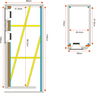

I will get some mdf and do it properly. How about this?:
I'd move the horizontal braces to just behind the woofers -- with the woofer magnets jammed up tight against the brace.
The second "vertical brace would be better if it wasn't parallel to the 1st one.
dave

well if you ding that (braces jamming woofers) then use a stronger bolting mechinism to bolth the woofer to the baffle than a simple wood screw.

I was looking at all the offcuts lying around, and there's a lot! (of long thin pieces) I'm wondering if I could just use these and place them in arbitary places both top-to-bottom and front-to-back. (In addition to the one proper vertical shelf brace)?
