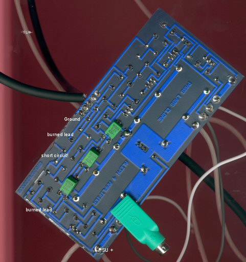

Hi Pass builders,
Recently I fired up (for the first time) two Aleph 2 power amps, equipped with Kristijan's pcb's.
One channel immediately worked fine, but the other one did not.
There was a little bit of smoke, and when I looked at it, it turned out that on the driver pcb there had been an electrical shortage.
The lead on the driver-pcb that goes from POWER + (45 VDC power in) to INPUT ground (both balanced and unbalanced grounds of input) has broken because of an electrical shortage.
BTW, I could not retrace this link between PSU + on to the input grounds on the schematics... Can anyone explain this link?
I examined the PCB, but I could not find any misstakes up till now.
The only thing I can think of is that I may have exchanged + and - power... (you never know!) when connecting PSU and Driverpcb...
Does anyone have any suggestion what might have been wrong?

Thanks Dane for replying!
Actually I DID match all the transistors, and I DID check all the connections. My first project Aleph 5 monoblocks were ok right from the beginning, so was the other channel.
I was just as astounded by the connection between PSU plus and Input ground....???!!!!!!!!!!
However, I could not compare this driver-PCB with the other PCB in the working channel....
BUT!!!!!!

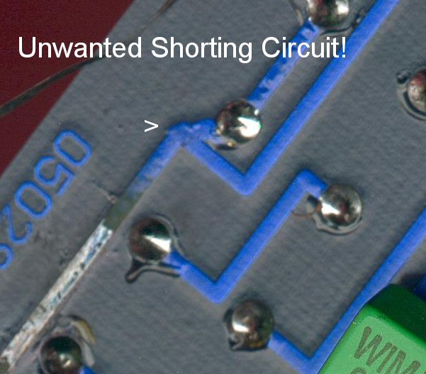

This morning I looked more closely in daylight at the PCB....:
KRISTIJAN, THIS REALLY SHOULD NOT HAPPEN!
There is a (unwanted) connection (actually a tiny, but beautiful lead) between the PSU plus plane and the ground plane!!!!!!
Mystery solved!
I will ask Kristijan to send me a new driver PCB, and meanwhile repair this burned pcb, and remove the unwanted connection by scretching it out.
Lucas.
Here is a picture of the pcb:
