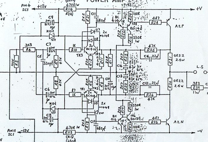

I am trying to fix an old (1985)Musical Fidelity A100 integrated class A amp.
The symptom is as follows, for the first minutes or so (up to 5min) one channel distorts heaviliy and then there is a small click and it starts to sound ok.
It also seems to get better if I do not switch it on for a few weeks, it will then be ok for a few start ups and then get back to how it was.
I just have a voltmeter and measuring the voltage over the output resistors R31 and R30 it seems that one (or both?) of the output transistors do not draw current until after the click.
I initially figured there was a bad solderjoint somewhere and re-soldered the whole board but no change.
Any ideas are much appriciated!

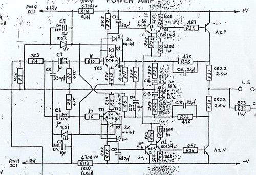

Check the input electrolytics. Looks to me like if the leakage is
high it could defeat the biasing - but I could be wrong (very small diagram)
I would expect to see a small dc difference between TR1/3 bases
and a ratio of this accross R30/32.
Dave /looks like Sajti beat me to it !!

A 8, Change the electrolitics, after all they are almost 20 years old and one of the top two failure modes is high leakage (passing DC current). Its a good excuse to upgrade the caps any way. Remember to do both channels while your at it and think about the power supply caps too.

BTW, am I right to assume that the quality/type of C10,C13 and C14 will not affect the the sonics of the amp?
A8, I would consider these to be in the signal path (even though they are AC shunts) so use good quality types. Do you have the room for film types (?) as there is not so much voltage keeping the electros polarised. Don't ask me about sonics

Hi A8,
C14 and C13 could well affect the sound quality because they are effectivly in the NFB loop - I would use good quality components rated at 105C here - Panasonic FC's, for example...
As to C10, the jury is out here. You may have already seen my Musical Fidelity A1 page - over the years I've had conversations with many people about the design. I've not found an absolutely convincing explanation for the C10/R17 series combination. I'd perhaps guess that it was determined empirically to ensure stability or perhaps improve distortion performance, but I'd welcome comments from people here.
The message from my page, based on my experience with these things is simple - change every cap! I can understand you wanting to "fix" the amp first, but it's important to realise that you can not attempt any form of logical fault-finding when you've got an amp with dried-up old capacitors! I know that others have already said this, but trust me - it's important 😉
Out of interest, how did you get the diagram? I know that it can be tough getting info from Musical Fidelity. Would you be willing to scan the whole schematic - I'd love to add it to my collection. Another reason for asking - I get a lot of email about MF amps , so I'm interested to learn anything I can about them!

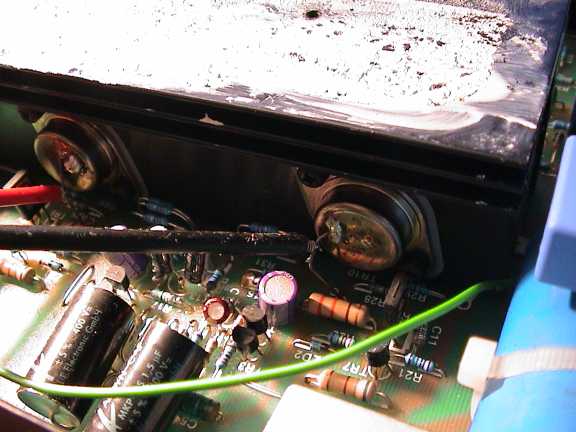

Hi guys,
So...I changed all the caps but guess what the problem still persists!!!
Now, by chance(I got fed up with it) I hit the shell (collector) on the PNP TO3 power transistor with a screwdriver and it immediately started to work. I repeated this a few times with the same result.
So now I am starting to think that the connection between the shell and the silicon inside is weak and/or faulty, perhaps because they soldered directly on to the shell?

This is how it looks and it the right one that seems to be the problem.

Could it be that the soldering on the TO3 case is not OK ? Please use solder lugs with a wire at both 3 mm holes. Much safer !
Directly soldering on steel TO3 cases is plain unsafe and technically not correct.
If the transistors are broken you better change them alltogether ( the good channel too ) for avoiding channel differences, no real need for matching. I never bothered anyway.
BTW I found the schematic of MA100 ( very similar ). Must have A100 too on paper somewhere but I forgot my promise to post it completely so I did not look for it actually.

OK, replace all 4 power transistors and use solder lugs at both sides. If they aren't used already you can use cut-off pieces Teflon insulation sleeve on the pins of the TO3's ( no PVC, no explanation needed I hope ). Use good insulation pads. Carefully check for shorts before powering the amp.
Aargh, the picture you attached with that white s**t on it remembered me of why I don't want to repair these kamikaze amps anymore !
