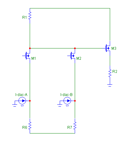

I will go balanced but this DAC gives four current outputs PER CHANNEL!
Klaus,
just a sliding decimal point (2x0,07 = 0,14 not 1,4)🙄
The disadvantage is that the original design uses two summing opamps per channel to perform the transformation double balanced to balanced.
I would like to keep the two halves of the DAC but must find a way to get a normal symmetrical current output to feed the D1 output stage. One possibility is to use only one half of the DAC but this would throw away the advantages of using two da convertors per channel.
william
William,
Just build a common gate input stage for each dac output and connect the drains together. This is a safe way to parallel those outputs (indirectly).

Hi again,
But what is the real value of this balanced to balanced? That must be asked. Theoretically it´s nice, of course. But for the price of four OPAs. I am quite sure: use two outputs parallel and feed one D1 stage. Its is "just" one time balanced, but enough. I can just tell you, the sound increase from the old solution "DAC internal symmetrical OPAs + OPA637 sum via cinch" to "full symmetrical with D1 clone" is hard to be described in words. Symmetrical transport will benefit, but most increase is coming from the D1-solution. I would not care to much about the lost second time of balancing – you replace it by parallel DACs!
Regards
Klaus
Rudolf,
thanks! I will have a longer look at this trying to understand the way it works (and probably come back with some questions......)
Klaus,
this is exactly what I would like to do if it´s no problem to just parallel those dacs (not so shure about this yet).
I agree that there is no advantage in the doubling of opamps😉 but just before that, in using two dacs to do the D to A conversion (less error).
One time balanced is enough for me but if it is possible I would like to use those two dacs per channel.
william
