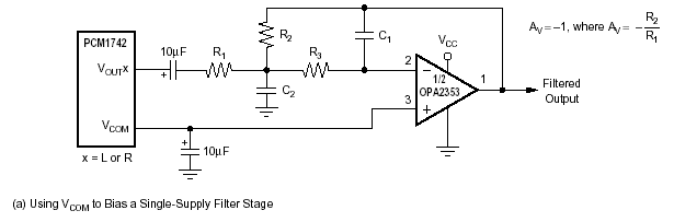

the DAC is a BB/TI PCM1752K, which is not listed on the TI site... closest thing i could find that was 24/192 in same package (16SSOP) was the PCM1742, at least the pin-out matches up. the stock output opamp was a JRC 4585. clock signals are derived from a crystal oscillator feeding a NPC SM8706C divider/generator
interestingly, the output opamp is operated in inverting mode. at first i was impressed with panasonic's care here - maybe they believe inverting mode sounds better! as it turns out however, this is just a byproduct of one of the suggested circuit configurations for the DAC. from the PCM1742 datasheet, it shows that the output is DC biased by about 1/2 Vcc, and you can source this bias voltage from a pin labelled Vcom. thus you can use Vcom to feed the noninverting input of an opamp and get a zero-bias output (see attached graphic below). however, in practice i still measured a strong DC bias before the coupling caps - about 2.5V per channel. so AC coupling is still required.
most of the stock caps in the audio section are decent-looking Nichicon, at first i thought they were Gold or Muse grade due to the gold sleeve but on closer inspection they are FW grade, which are a lower-grade miniaturized version of FG (the lowest grade Muse). on the plus side, FW is still considered an "audio-grade" capacitor by Nichicon, so they are bound to be better than the ubiquitious cheapie Nichicons in the navy blue sleeves...

dorkus,
I don't know what the heck I was thinking when referring to that ADV chip as the audio DAC... you'd think the "v" would have clued me in... Anyhow, I just went through my pictures again, and there is a little BB DAC hiding in the corner of my RP-62 PCB... a PCM1742. Makes sense, given yours uses the PCM1752.
The stock opamps in the F-85 are JRC4580's. After modding my Sony NC-650V DVD/SACD player I was sold on removing the muting transistors. (There was a very noticeable improvement in SQ). Fortunately, my roommate is kind of scared of my equipment, so he seldomly even touches it. I am very carefull about turning the unit on and off with the volume knob down, and fortunately, I haven't had any severe pops, YET...
As you mentioned, there is quite a bit of DC offset at the output of the DACs. I found the datasheet for the PCM1606 (I'm assuming this is the precursor to my PCM1607). In the datasheet, it says ...
This would lead me to believe it has about 2.5V offset....These are unbalanced outputs, earch capable of driving 3.1Vp-p typical into a 5-kohm ac load with Vcc = 5V. The internal output amplifiers for Vout1 through Vout6 are dc-biased to the common-mode (or bipolar zero) voltage, equal to Vcc/2.

be careful with the DC offset, if your cones are definitely moving then you are causing the voicecoils to heat up, which is detrimental to the life of the speaker. i imagine the reason it settles down after a second or so is the parasound's DC servo time constant is on the order of that amount of time, but you should still not push it. if your cd player is putting out anything more than 100mV it really ought to be blocked.
coupling caps can actually sound pretty good, and DC Servos have a sonic signature of their own. which one sounds "better" is a matter of implementation and personal taste - many people here actually prefer a cap to a servo. i do not think the "graininess" in your system is a coupling cap, even if it was the stock one in the panasonic - after playing around, i realized that it actually sounded pretty good! if anything, it's that Adcom preamp. i'm not sure what model it is, but in my experience most mid-fi preamps like Adcom really stink sonically. grainy, dry, uninvolving... get rid of it! you're better off with just a passive volume pot, really.

The adcom is a GTP-555. i use it because i need some source for switching as a preamp. i have a denon avr-2700 reciever that i use for HT that runs the main outputs into one of the inputs on the adcom. the denon actually has a significantly "smoother" sound to it in the preamp section, but the adcom is remarkably more "open" in soundstage. It's a tradeoff, but i guess i prefer the depth and openness. As i said, the adcom is the next thing to go/change in my system. I'm looking at doing my own preamp design, something similar to the project on Elliot's Sound Pages perhaps.
With regard to the sound quality of DC servos, I don't really know, because I haven't played with them much yet. But, the only way to know is to experiment and find out for myself. In the interum, I will most likely add coupling caps to the output, but I may just pony up and spend $50 on paralleling a bunch of film caps. Then again, maybe I'll be my normal cheap self and just pull a bunch of cheapies out of my stash of parts. 😉
