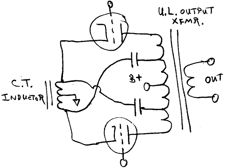

Single supply version
This is the schematic for a single non-floating (ie. traditional) power supply Elliptron. The capacitors in the cathode circuits may be a problem here since they will change voltage after a large current load. My hope is that by putting a similar sized capacitor in the power supply (from B+ to ground), their effect on the cathode feedback voltage for the grids will cancel out. Any comments?

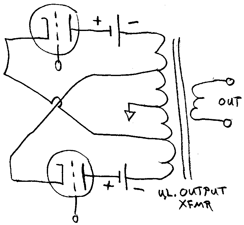

Already invented !! Darn!
It seems that the "elliptron" circuit was already invented (or very close to it), at least by 1981:
http://digilander.libero.it/paeng/srpp_vs_gomez.htm
(note the +A and +B power supply connections on the output transformer at the UL tap connections and the other end of the floating supplies, -A and -B, connected to the cathode circuits)
Darn, thought I had something new. Has everything already been invented!
Sorry to be sounding negative but this coupling has most certainly been tested long even before the reference article you refer to was published, I think I remember it mentioned in a book by Terman from the 1930-ties.
There is a tendency in the tube business today to re-invent old ideas and claim that they are new and revolutionary but in fact they have usually been tested, tried and discarded as not good solutions long time ago, the same hold for almost any industry including SS technology or in the car industry.
Try to find a library containing old tube technology books and you can find a lot of ideas that sounded good at on time but didn't hold into commercial products. I am very fortunate as my father who now is 85 years old was heavily involved with tube manufacturing and tube circuit technology during a large part of his professional carieer and he has given me all his old reference books, I am always enjoying reading about all the wild ideas that was up on the table at one time.
Regards Hans
