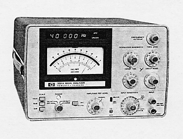

this will work
these HP 3581 "wave analyzers" will really fit the bill -- they are very sensitive, have excellent resolution and have been pretty cheap on EBay of late -- anywhere from $50 to $120. The unit has a built in sweep generator and very fine resolution. You can also get a companion plotter which accepts the 0 to 5 VDC out and graph the results.
Here's the link to the HP3581 manual I put on my website:http://www.tech-diy.com/hp3581.htm
