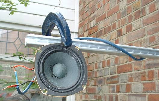

I use a Workmate opened up enough to mount the driver on its back firing upwards. I put a couple of rubber pads between the Workmate and the driver with just 2 small clamps ( one on each side of driver ) to keep it from vibrating, especially during resonance. I always get a nice clean impedance curve using the LMS system.
Works for me:nod:
PS:
The clamps I use are the plastic squeeze on types found at any build it center eg. Home Depot. I use various sizes depending on the size of the driver being tested.
In case you don't know what I mean by a Workmate in the UK I've attached a photo.

I've read several references that recommend measuring the driver in its natural position i.e. firing forwards.

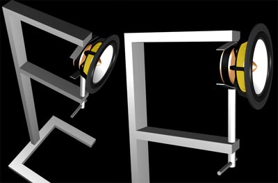

Since I've got the materials and will probably be doing this a lot, I want to build a dedicated jig for driver measurement. It should have the ability to hold a driver 3' in the air, firing forward , and handle magnet assemblies up to 25cm diameter (my sub magnet is 20cm).
This is my idea:

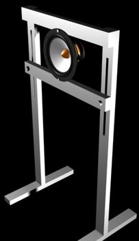

Oh that's just me getting carried away as usual. My approach is to just go OTT and never have to worry about it again.
I think I'll settle for this inherently more sturdy design, and i won't have to worry about anything touching the magnet assembly either.

Awesome looking designs you came up with though:nod:
Doug
Yeah it does look nice doesn't it 😉

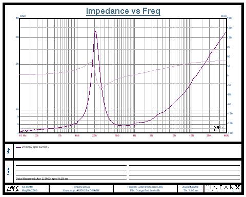

What software are you using? I'm attaching an image of an impedance / phase plot I did recently of a cheap 4 inch speaker that came out of a TV set. I hope I adjusted the pixel width right for this post as I can't preview the attachment before I submit.

A difference of 60 ohms seems a bit much. I would check the software you are using for sure. If I get the driver to close to a reflective surface, I notice a slight difference in the impedance plot, but only a couple of ohms here and there at most.
You mentioned that all of your measurements were made near the floor, so if the driver is measured facing upwards, the rear of the driver is close to a reflective surface, but when you orient it so its upright and firing forewards, the reflective surface isn't there, hence the difference in the impedance. But still, a difference of 60 ohms is way to much of a difference.
BTW You didn't mention what software you were using.
Doug

BTW, I like the look of your second design better 🙂 I used a couple of saw horses with the edges of the woofer clamped with G clamps a bit like pink mouse. Just got someone to sit on each saw horse to make sure it was stable 🙂 I think the biggest concern will be whether you will get resonance in the steel structure itself. I guess its a trade off between being as close an approximation to free air, and being sturdy enough to keep vibrations to a minimum.

...whether you will get resonance in the steel structure itself.
I thought the same thing. The steel is 2mm thick and hollow, so I will it fill with sand where I can to increase the weight. I was thinking about additionally using weights on the floor beams to hold it steady, but I've already taken it all to a superfluous extreme considering the approach of others.
Hey I don't think it is extreme. The sand is a great idea, that should make it very solid (although you better pick it's spot well as it may be difficult to move after filling 🙂 ) The only reason I used a couple of saw horses was that it was all I had. If I had something better I'd use it 🙂
