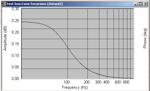

I was looking at some morel MW-144 drivers for use in MTM config with separate sub. GM warned me that the power handling of the driver was pretty low bleow 90Hz.
Morel rate these drivers at Nominal power 150W DIN and show a freq response graph going down to about 50Hz (vented I assume).
I was thinking of using the drivers in a sealed enclosure for better midrange detail.
to make things simpler, I did some modeling with a single driver in a sealed enclosure, unibox says max power handling 11.9W!!! long way from 150W!
Seems that X max is reached at around 160Hz. Cone excursion with 150W input at 80Hz is around 10mm (Xmax of driver is 3.5mm) which I assume would pretty much destroy the driver.
Surely there is something wrong here! Morel are praised for the exceptionally high power handling ability. Is this power handling assuming that the drivers is not driven below about 200Hz, or is the construction of the driver such that normal calculations don't apply, or when xmax is exceeded the distortion is minimal, and does not cause damage?
I went and modeled in boxplot, and it shows me a power curve that suggests I should be able to get away with about 113W at 80Hz in a sealed enclosure, I'm really confused!!!!!
I don't know how to interpret the cone excursion graph in speaker workshop.
Any suggestions greatly appreciated.
OK, so? Does it say it can use all 150W at 50Hz, and if so, at what % distortion?
At what frequency?
Depends on what its Xsus and Xmech specs are.
The calcs apply, but WRT the others, more tech info is required to answer them.
Me too, as I don't get anywhere near this, but I do get far more than 11.9W/80Hz. What f3 are you simming to? Are you using the demo version or paid for 3.0?
Not familiar with it. What info does it give?

Hi GM,
It doesn't say. I guess it's misleading though if they show a graph down to 50Hz and then say power handling 150W. Sort of implies that it should be ok up to the rated power handling.
Unibox doesn't say what freq, just says 11.9W (and the explanation is "Maximum allowable power to keep driver within linear excursion range"
Unibox suggests optimal volume of 4.6L (Qtc of .707) I modeled it at 5L which unibox says is F3 of 85.5Hz, Fb 84.6 Hz.
From the look of the graph in boxplot f3 is around 88Hz with this box volume, (note I didn't save the sim before but with these values the power at 80Hz is around 110W, but dropping steeply, flattening out at about 55W around 30Hz. obviously I can't just stop at 80Hz, even with an active xover, but this is just for example purposes.
It's the unregistered demo version of boxplot 3.0. Not really familiar with it, but thought I'd give it a try to see whether it gave different results to Unibox, which it did!
I've attached the graph out of speaker workshop, but the excursion in db's doesn't make any sense to me........
I'm probably missing something somewhere, but it seems strange I get such different results between two modeling programs (unibox and boxplot), both of which have been around for quite a while, subtle differences I could understand, but massive ones??? (unless I'm just completely screwing it up 🙂 )
Maybe I need to go and re-read the destructions!
Tony.

DIN and IEC power handling tests use filtered noise signals. The filter rolls off the bass and thus the test is a thermal power handling test - having to do with how much heat can be dissipated by the voice coil.
Excessive excursion at low frequencies is a mechanical thing and has nothing to do with Mfg. power ratings.
Morel's power handling reputation is similar to Dynaudio - they brag about pulse power into their tweeters and low compression in these tests. They usually don't mention the woofers. I have never used them, but the reputation is that they overload gracefully.
Woofer excursion predictions are based on the assumption that all parameters remain linear with increased power, but they don't. Stiffness goes up and Bl goes down with increased distortion - this eans that excursion predictions from programs are over conservative and the driver will often handle perhaps 2-4 times the power predicted. The expense of the nonlinearity is compression and distortion.

I wouldn't wory about the Morel's handling the rated power.
Unibox is great at showing exactly how little power ratings mean. I modelled a Seas Excel W22EX001, rated max power = 120 Wrms, and found that it reached xmax at 20 Wrms. But as I found out, it means very little. What does count is the amount of spl output you get before reaching xmax, and whether that is acceptable to you.
I love Unibox. This figure is more useful. As Ron mentions, the 150W DIN figure is merely the amount of power the driver can take before failure (burns voice coil, melts adhesives etc.), and nothing to do with keeping the driver in a usable range.Unibox doesn't say what freq, just says 11.9W (and the explanation is "Maximum allowable power to keep driver within linear excursion range

I've heard that some of the graphs in SW are labelled wrongly. It's probably not db (which doesn't make sense) but in mm. Measure it up against your Unibox output and see what you get.I've attached the graph out of speaker workshop, but the excursion in db's doesn't make any sense to me
Thanks Guys,
that clears things up a lot. I guess I can go back to my original plan of crossing over somewhere between 200 and 300Hz if I wan't high (edit distortion free) SPL. Had been given a suggestion of running them down to 80HZ and using my Vifa 10"' woofers purely as subwoofers. This from a HT perspective, more than a stereo perspective. They will do both duties (eventually, stereo to start off).
So near but yet so far, the more I learn the more doubts I have! I was blissfully ignorant before 🙂
I guess I can take the approach that whatever I'm going to do it should be a lot better than my existing setup (unless of course I was so incredibly lucky with it, that it defies logic!)..... I think most people here would probably die if they listened to my current speakers (and I don't mean in extacy). I know I nearly did after hearing a pair of Infinity Electrostatics paired with two six foot tall subwoofers with 6 X 12" drivers in each, All run by some monoblock amps weighing 500KG each (there was a sign warning that you should get an engineer to check your floor could handle the load before purchase!). I came home, and turned on the stereo and nearly cryed 🙂
Only one way to find out though.....
Tony.
OK, Unibox appears to be listing the Xmax -24dB displacement power rating, though I'm not sure why.

Just so we're comparing 'apples to apples', here's the specs I'm using:
Xmax = 0.36cm
dia = 10.69cm
Vd = 32.311cm^2
Qts = 0.3625
Vas = 12.34L
Fs = 45Hz
For a single driver in 5L: Qtc = 0.6344, F3 = 94.81Hz/70.3W/100.49dB/m, Fb = 84.09Hz.
For Qtc = 0.707: 3.623L, F3/Fb = 94.46Hz/69.26W/100.43dB/m.
It has a number of 'bugs', so I wouldn't pay too much attention to its accuracy. It's really only meant to give you an idea of what you'll get for $25. Well worth the few $$ IMO. I use it all the time to do quick comparisons.
That's a phase plot. Do you get the same graph when you ask for a phase plot?
Anyway, while you now have a better understanding of power ratings, etc., like most things in audio you'll have to listen/experiment with the driver if you want to push it beyond its low distortion spec rating to find its/your acceptable distortion limit regardless of what alignment or program you use to sim it.

I checked but SW doesn't have a phase plot graph, but on comparing the supposed excursion graph to what unibox produces it looks very simmilar, I think it probably is an excursion graph, the scale is just meaningless. (sorry there is a phase graph, it's on one of the freq response graphs, and yes it does also look very much like the plot I attached).
OK, but even so, at a glance it doesn't look right. If I get a chance I'll check it further to see if I can get the correct scale if the plot proves accurate.
Don't worry about it too much GM. I can use the other progs. SW is good for testing, but not as good for modeling IMO.
