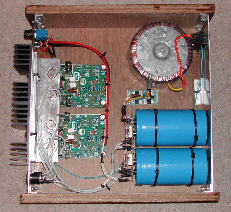

Here's the innards -
PSU is a 35-0-35, 625VA transformer and 2 x 22000uF caps. Rectifier was built on another Avondale PCB using (IIRC) BYW51 fast-recovery diodes.
The internal power wiring is mostly Silver Anniversary bi-wire (as it's basically very chunky ribbon cable), and as you can see I've tried to avoid supply & return currents from forming any loops of substantial area.

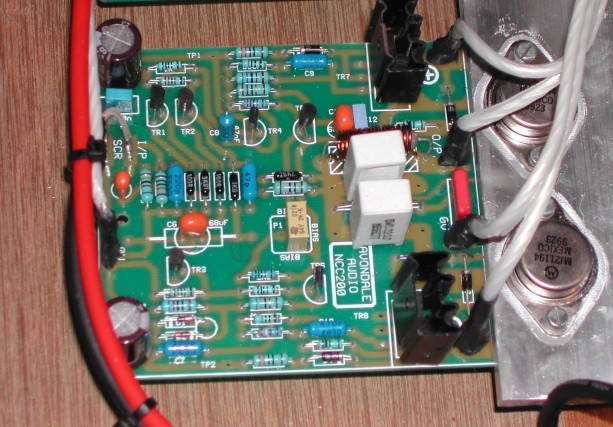

Here's a closeup of the module itself. I bought the bare PCBs and all the other bits come from Farnell. I made a few transistor type substitutions - BC546s for BC182s, because the supply voltage was right on the Vceo limit, and MJ21194 output transistors.

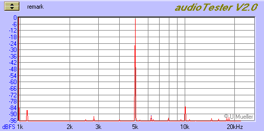

Measured performance is excellent:
Power output is about 90W into 8ohms, 180W into 4.
Frequency response is about as flat as I can measure, (<0.1dB, 20Hz-20Khz).
Sine-wave distortion seems to be entirely 2nd-harmonic, at about -80dB, at pretty much all frequencies/power output/load
combinations. The trace below was at about 10W out into 8Ohms, at 5Khz.
No measurable hum / PSU breakthrough at the output, and no detectable instability with long leads, capacitors, loudspeakers, etc.

li_gangyi said:hmmm...interesting...I have a question though...is the flat pack mj21194 better or the TO3 version?? I assume it's the TO3 one...
Given a choice, I'd go for the flat pack one, as it's easier to mount (by basically clamping it to the heatsink with a big bar of aly), and there's no 'case' connection via screws & insulators & whatnot, but the PCB is for the TO3 one.
Cheers
IH
perhaps you can saw off a little part of the PCB...thin out the tracks and drill a few holes for flat-packs to be installed...or use a few pins sticking out for mounting...a little messy looking though...but izzin't TO3 suppossed to conduct heat faster?? Or is the flat pack better in this area...??
li_gangyi said:perhaps you can saw off a little part of the PCB...thin out the tracks and drill a few holes for flat-packs to be installed...or use a few pins sticking out for mounting...a little messy looking though...but izzin't TO3 suppossed to conduct heat faster?? Or is the flat pack better in this area...??
According to the datasheets, both have the same junction-to-case thermal resistance (0.7 deg C/W), but ... the flat-pack is rated 200W at a 150 C junction temperature, whereas the TO3 is 250W and 200C.
So, roughly speaking, they are the same thermally, but you can run further into the danger zone with the metal TO3 case.
Cheers
IH

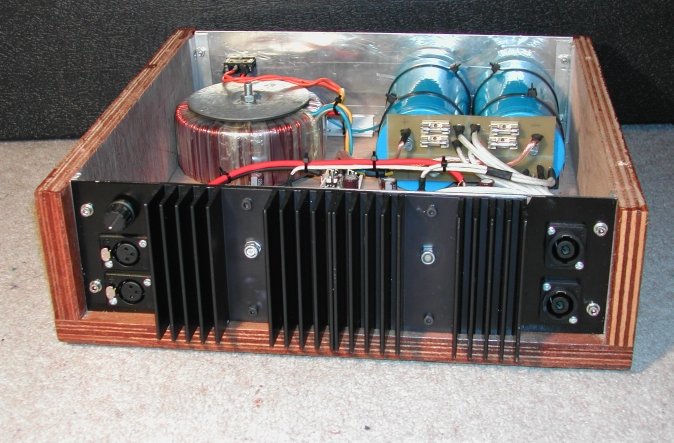

Da5id4Vz said:Very nice.
XLR and Speakeron connectors, is this for your home Hi-Fi?
Yes, although I'll also use it in my home studio; I've grown to like the robustness of studio-type connectors. Speakons in particular allow very easy and quick A/B tests on leads, amps, and speakers.

More temptations:
With the XLR inputs do you find that you have to run the input pots at very low settings 10 account for the +4dB to -10dB difference?
I'm actually envious of the speakerons. They are too convenient. A friend set up his broadcast facility with a speakeron patch panel so that he could swap amps and monitors on the fly. Very convenient.
