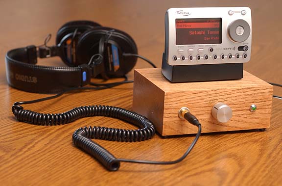

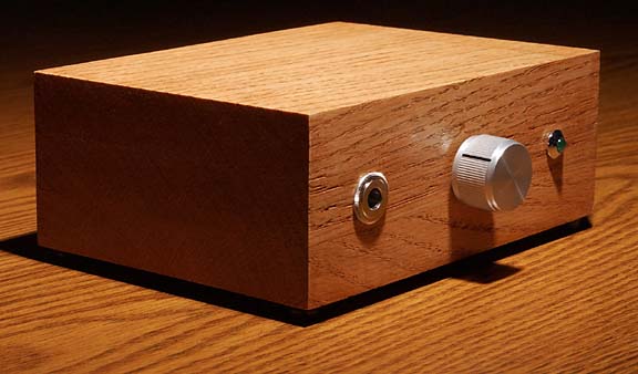

Way beneath most of you guys. But it is the first amp I ever built, so I thought it deserved a decent DIY'd case.
Alas, a tree had to die. I used a small board of red oak, cut into three pieces. The first two had a space cut out with a drill and jigsaw, then I glued them together for the box look.

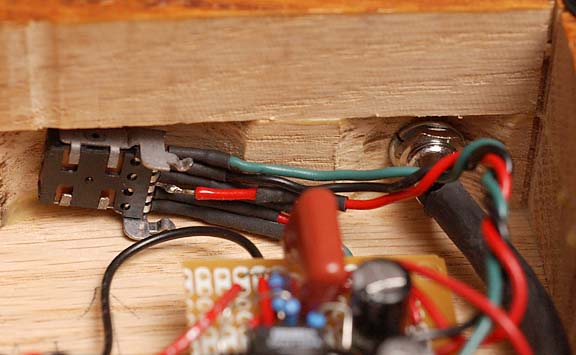

Still had to shave the middle piece down to get about 1/8" wall for mounting the Pansonic pot and the LED. Used a Dremel for that.
I love the sound, even though I have heard the better-rated META42 design I am recasing in an old cigar box. (Maybe it sounds better because I built it...) That project is on hold, however, as I have the bug bad enuf now to be doing a GainClone.

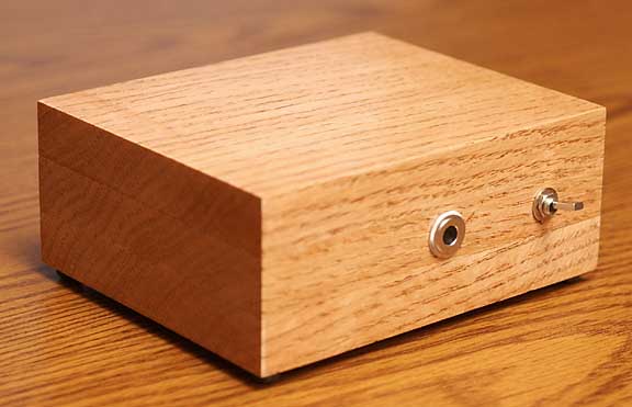

I finished this a month ago, but had been waiting for the next incoming Digikey order for a better nob. The tiny one I had just didn't look right.

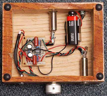

There is some sloppiness inside (and some outside!) so please be gentle with the comments....

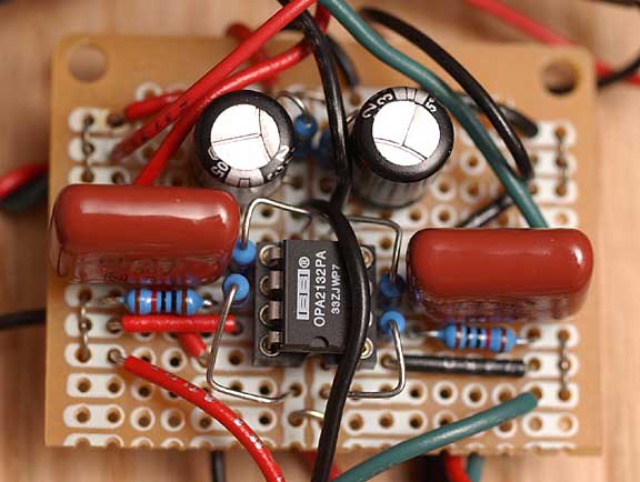

...and the circuit board close-up.

Battery lasts about 50 hours at pretty decent volume. Very simple, with nice, clean DC.
