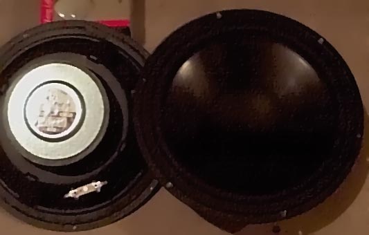

I am much interested on the "peerless - bass shy" thread below. Glad that the CSX 10" woofer gets attention.
I would like to try the CSX 10" in sealed enclosures in stereo bass modules to accompany my fulll range drivers with XO aro 140 Hz.
I have questions to the experts here - glad fore any replies. I am just a beginner myself but I got myself powerful software LspCAD which I now play around with.

Up until last nite I was running CSX10s for bass. I had them in sealed .7Q enclosures and they had good in-room output to 30Hz. A pretty good driver for the money, IMO.
I agree with you on the sealed enclosure/room gain comments. I wind up with ~flat in-room response with all the sealed enclosures I've tried. Why build vented and then have to EQ down to achieve a good response? 😉
As for box size and tuning.....Too large an enclosure will have the driver rolling off too early and can be considered dry sounding. Too small an enclosure and you wind up with a hump in the FR before the FR starts to roll off. Transient response/Group delay also suffers.
In my room, a Qtc of ~.6 seems to blend well with my room gain and yields ~flat response/nice smooth rolloff. 🙂

46 liters unstuffed gets you ~.71 Qtc. Fully stuffed ~.66. Should work very well either way.
