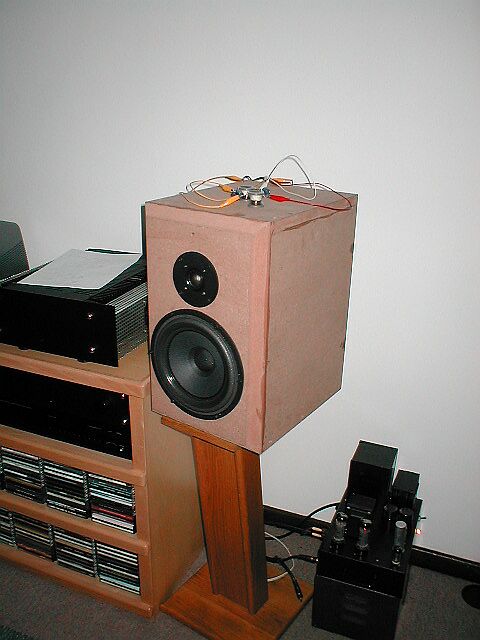

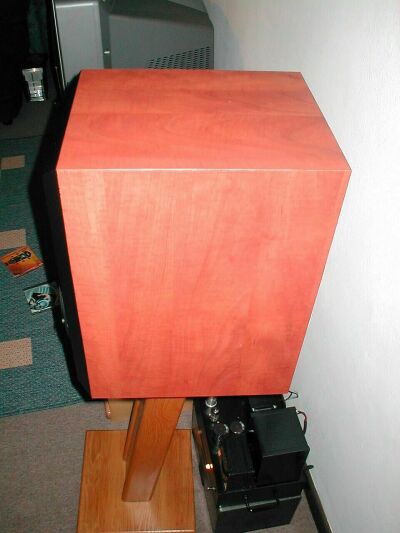

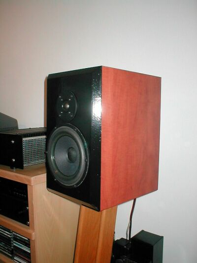

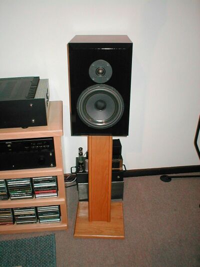

I just finished my speakers consisting of ScanSpeak 21w8552 and D2905/9300 drivers. No cosmetic treatment yet and only basic 2nd order x-overs with 1mH and 7uF components. Even like this, compared to my existing Monitor Audio Silver3's, they sound absolutly great. At last I can experience some decent bass and clarity. Sound stage are also much better defined and room is actually filled with sound, not so directional as before, anymore.

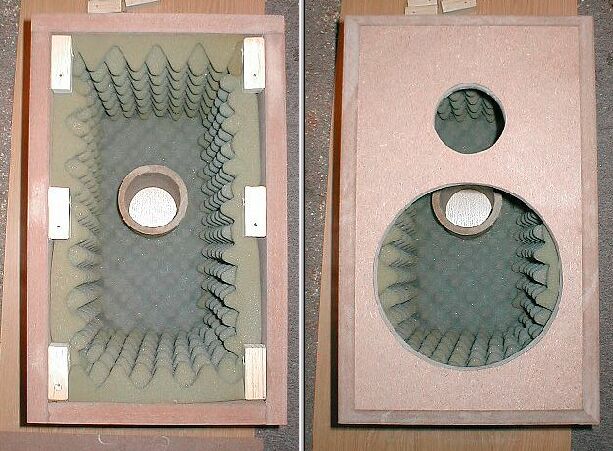

Cabinet is from 22mm MDF, glued and screwed, 30L - Fb 44Hz. I also found a easier way to fine tune port length - accidentaly. I tried the method of lightly touching cone and moving adjustable port in and out, but could not feel exact or even close Fb. Then I tried to look at cone and see any change in movement. To see I used flashligth with adjustable focal point. As I moved port, I saw tiny white line on edge of cone, getting longer and shorter. It was a piece of wood dust that with the vibration appeared as a solid line. The frequency where this "line" was at it's shortest, was between 42Hz and 45Hz. Difficult to judge a short , thin line's length, if it is not even 1mm long - exactly. The planned Fb was 44Hz, so it seems like I am very close with my calculated port dimensions of 76mm x 170mm.
Now I must find somebody who can help design a proper x-over circuit. Any suggestions/volunteers ?? 😉
Is it O.K. to fit this type of foam and so much (top, back, sides and bottom) for damping?
Some early pics:
