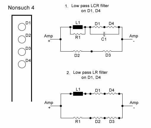

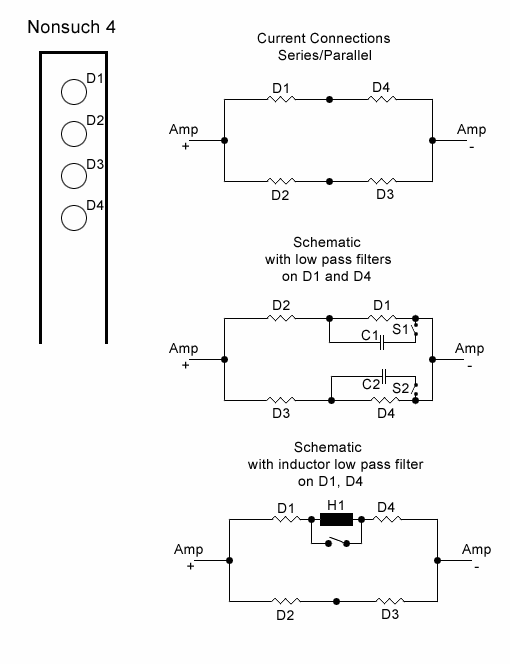

Low-pass filter network for mini-array
You may know me as a bit of a purist when it comes to speaker design.😉 However it occurs to me that there may be some advantages in adding a low-pass filter (switchable of course) to the Nonsuch 4s outer drive-units.
Such a network could both act as a baffle step compensation circuit and as a way of virtually eliminating the comb effects that make the Nonsuch 4 a 'stand-up-and-you-lose-some-of-the-high-frequencies' speaker.
I'm not an electronics designer and my knowledge of crossover circuitry is basic so I thought I'd post this to get views on whether this will cause more problems than it is supposed to solve. I've attached my initial schematics below.
I quite like the capacitors approach as it allows two switch positions for more flexibility in baffle step compensation. Also, when it's switched off there's nothing whatsoever that can adversely effect the performance of the speaker.
However, as the drive units are nominally 4 ohms, the overall impedance would be only 2 ohms at high frequencies. Also, the output from the inner (full-range) drive units would be variable above the low-pass point.
With the inductive approach there is less flexibility as the filter would effect both outer drivers at the same time. The impedance problem would be solved. My concerns are that the inductor would add some phase shift/time delay to the outer drivers and also my network theory is not good enough to be sure what would be the effect on the output of the inner, full-range drivers above the low-pass point.
What do you think?

Either circuit will work... you are essentially making it a 1.5 way speaker. You do have a phase issue as each of the outer drivers rolls thru 90 degrees above their XO point and the 2 inner drivers don't -- this is one of the reasons i'd mount them on the back 🙂
dave
planet10/just call me bi-pole dave

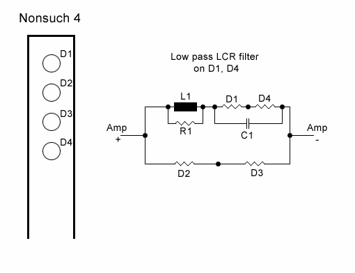

Latest iteration of the network
Below, is the latest version of the network. This version seems to solve the question of varying power at the middle (full-range) drivers.
There is some question about whether the circuit is stable or whether there could be oscillations.
Also 'BPTL Dave' and others, what happens in the time domain (phase, delays) to the filtered outer drivers below the low-pass frequency when they are working at full power? This is where I think things are most critical and I wouldn't want to compromise the coherence of the speaker.
Also, can anyone tell me whether I can split C1 to shunt both drivers so I could vary the capacitance and the frequency to each?

Simpler version
... and to add a simpler alternative, No 2 of the schematic below may be the best bet. R1 is the DC resistance of the inductor L1, added for balancing purposes.
I think I'll try it and see.

Re: Latest iteration of the network
You would then get roll-off at 2 different frequencies -- but anomalies would be half as intense... might be worth a try ...
What is the purpose of the LR -- looks like a BS compo filter.
dave
Re: Re: Latest iteration of the network
The LR (number 2.) is a simpler version. The purposes of both circuits (when switched in) are:
1. To partially compensate for the diffraction step.
2. To cut down the comb effects at high frequencies (over 10kHz), allowing 'stand-up listening'.
3. To boldly go where I've never gone before with these speakers but always with a safety net.
I have to play with the circuits and see if there is any audible improvement. Any perceivable loss of clarity, coherence or transient response and they're OUT.
This has basically come about through postings on this forum of people who I respect as designers, although I don't necessarily agree with all their views. Generally, I'll stick to my basic design principles and fight my corner but I do listen to other views and I will try alternatives if it's reasonable to do so. I'll let my ears and the trusted ears of my wife and certain friends be the final judges.
:goodbad:
PS: What's a BS compo filter
Steve,
refering to Your schematic No 1 "LCR lowpass filter for D1 D4":
when You`d leave out R1 You have a pure second order low pass with the according phase shifts.
For "smoother" phase response You can play with "reasonable" values of R1 (too high and it has no effect - too low might cause amp stability problems as C1 shorts D1 & D4 at high frequencies) in order to get something between (almost) a first (6db) and a second order filter .
This circuit is more flexibel as You have more possibilities to tune it (freqeuncy AND Q) and it might turn out to be the better solution (as compared to a first order filter in schematic No 2) and I wouldn`t reject this completly.
As they are identical drivers and as You still have the benefits of a line source at lower frequencies (which is the main advantage IMO) I wouldn`t worry about coherence too much.
When the circuits are beneficial soundwise (what I believe they are) the next step could be a NONSUCH 5 with a single center driver playing the high frequency range alone and with two different lowpass circuits for the "outer" pairs for even increased vertical listening area at high frequencies .
Your idea of making the circuits switchable is a good one IMO!
So people could choose beteen line-source sound (BTW: I think You`ll need baffle step circuit for this anyway also) or towards "point"-source sound.
I`d be VERY interested in what You find the differences are between this two approaches.
