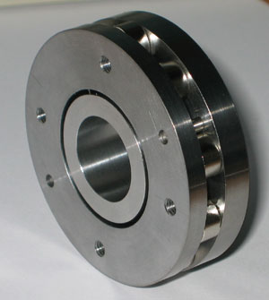

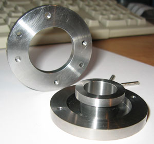

So I've ordered my neodymium magnets to use in a midrange-size design as a learning exercise. I did a search to see what pointers I could get, but the discussions I found were a bit over my head.
My questions are of the type:
Why is the voice coil centred on the front plate instead of in the middle of the magnet?
What meterials are these plates/pole piece made of?

Thanks for the that Octupus. After some researching, I concluded that the magnetic circuit will harness the flux into a tiny air gap. I think that by using the top plate to create an air gap, the flux can be controlled into a narrow band which is better than using just a high magnet surface, especially as uniform flux is one of the goals. I though about using two ring magnets with opposing poles on the inner and outer ring surfaces. The magnets can then be the required height and there will be no loss in magnet strength from travelling through other metals. This was just one idea that I may try later. I don't know what the issues are with doing it this way. I certainly haven't seen this done before...I've just whipped up an image below, I think the reason is that the pole piece is say, North, and the rest is South, I think. And the voice coil repells off the magnet flux...maybe someone could clarify

The magnet provides field(it acts like a battery in a magnetic circuit) the top plate and pole piece concentrate it and put it where you want it. You want the field perpendicular to the coil windings at all times.
Force on the coil is B*L*i, where B is the magnetic strength, L is the length of wire in the gap and i is the current through the coil.

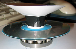

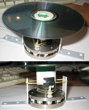

I tried a circular piece of rubber sandwiched between two CD's (with a larger diameter cutout) today. I cut it out of a rubber washing up glove, making sure that the inner hole was really small so that it would fit very tightly on the former. It worked really well. In fact, I'll probably use another rubber glove to make the cone surround.
