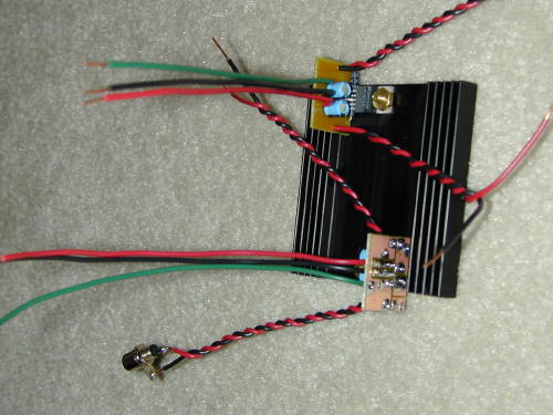

I recently completed my first chip amp. LM1875s, 0.1% metal film resistors, 10uF noname caps, my pcbs, 12V 7Ah SLA batteries, and tons of inspiration from everyone who posted questions, comments, pics, schematics, etc.

Now for a pic of the bottom...
Sorry about the pic quality, but this is to show the scale. The feedback resistor is hiding behind the chip. Everything else can be seen. No coupling cap on the input here!
Oh yeah, because it's an inverted amp the red output lead is connected to ground. Just in case you were wondering.
PSz.
PSz.

Having looked at your bare PCB it is now clear to me where the name gainCLONE came from !!!! 😉
