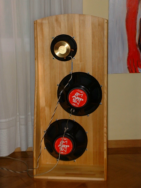

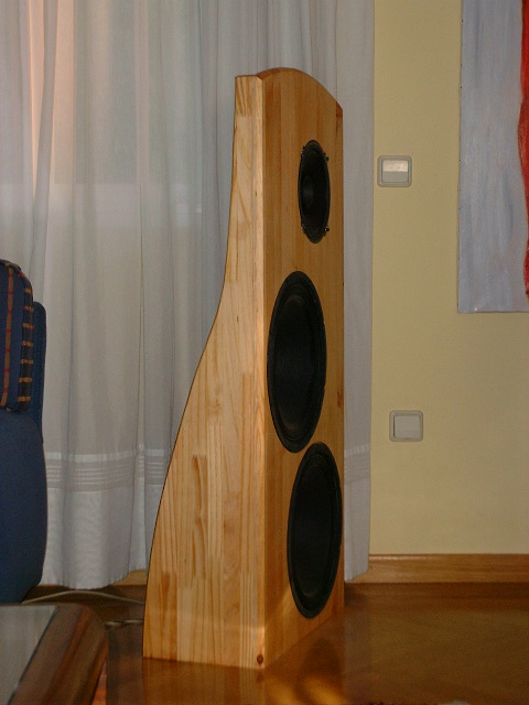

Find attached the photos of my just finished dipoles.
A lot of inspiration has come from the people in this forum, from the Thunderstone forum and of course from Linkwitz, so thank you all very much.
The full range speaker is a Supravox 215 Signat Bicone and is run full range with a PSE el34 amp.
The input for the two 15" woofers is taken at the full range terminals, with 10k series resistence and 1 uF to ground.
The 15" are cheap locally available speakers with Qts =0.4, 99dB, and 6mm Xmax. They perform very well, and barely move.
And guys, you where right, bass is excellent. And surprising.

Hi Ashok,
I will wait for the drivers to break in, make my measurements and see what eq is needed. Doesn't sound like too much to my ears.
Forgot to mention that the woofers are driven by a 50+50W transistor amp.
The input of this second amp is feeded with the signal taken at the speakers terminals of the full ranger amp throught the RC filter, to compensate for the 6dB dipole rolloff.

Hi Variac, Chops, spa317 and all,
The wood was bought as you see it, only glueing sides and bottom.
Agreed, huge woofers are a must. If you survive your wife's reaction on your beautifull looking Basszillas, you should try open baffle on the subs also. Follow Chops threads. You will be amazed.
Thank you Chops for the nice words. In fact it was your enthousiasm with your 15" woofers that finally pushed me in this direction.
And the equalization you are using.
The full range speakers are rated 95dB. I am getting all the volume I need out of a PSE el34 delivering some 12Watts.
Note that the woofer are feeded by a separate SS amp.
I bought my Supravox from the local distributor. Last time I saw the list price was around 300 euro.
Drop a line to www.supravox.fr, and they will tell you if they have a distributor where you live.
I cannot compare the sound to the Fostex. I have not had the chance to listen to 208E. In fact I did not have the chance to listen to my own Supravox before purchase, so it was a lucky bet.
You can read other people's opinion on Melhuish's single driver website.
Regards
Miguel
