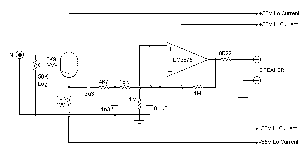

I started this thread in the chip amp section, asking for help designing a constant current source for Joe Rasmussen's tube gainclone project. Maybe there will be more interest here.
I read this article by Nelson Pass which describes some current source designs. I was thinking about using the mosfet version, with a 1N936 temperature compensated zener (since I happen to have some on hand).
Joe's circuit is attached for reference.

A (probably stupid) question about your ccs suggestion: Does it depend on regulated supplies, since it has no voltage reference?
Sparhawk said:Okay, it was a stupid question, since this is a JFET ccs, so it doesn't need a voltage reference. I guess this is the quietest way to go. I notice that you recommend a higher B+ voltage, too.

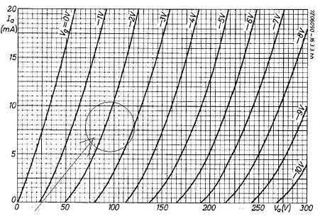

Only 35V for +B voltage is minimum, IMHO. For my taste, Va=ca +100V, and Ia=5-8mA are optimum values for this application.
Your Q are OK, don't worry.

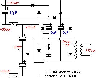

thank you both for answers about posting pics. Here is one interesting PS schematic (voltage tripler) for getting high +B from 24Vac ct source. By adding -24V regulator (7924 or so), whole PS for HGC-CS can be implemented easily (just a thought).
You can find out more at: www.tubecad.com/march2001/page24.html
Regards

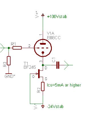

Moamps,

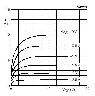

Would R2 be necessary? Or did you put it there to protect the Fet against turn-on transients?
From looking at the BF245 datasheet it seems to me the BF245B is the better candidate for the job or I'm I mistaken?
Another silly question showing my ignorance of all things solid state: are yuo regulating the -24VDC supply with something like an 7924 or similar?

fdegrove said:Would R2 be necessary? Or did you put it there to protect the Fet against turn-on transients?
R2 sets the current for the ccs, doesn't it?
fdegrove said:Hi,
With R2 you can set Id (Ia), and noise figure is slightly better; without R2, Id is determinate with particular FET characteristic.
We can use ordinary 7924 here.
I didn't try in practice this circuit (and PS) yet. I will, but haven't time in this moment. I agree that BF245B (and C) is better solution; I use them just for example.
We must (altogether) spend more time on this idea (theoretically and practically).

Yep...my penny dropped a little too late...
I think it will work as shown- the CF part anyway-, I have a similar circuit to yours but with the CCS in the anode load using a BF244A at 1mA.
