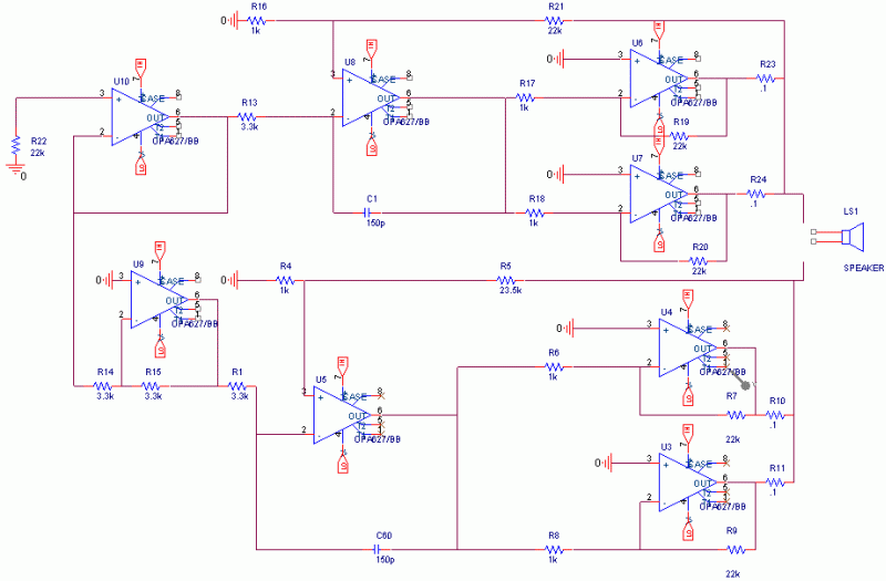

Bridgeclone:
Four lm3886 "controlled" by high performance opamps.
here is my idea
