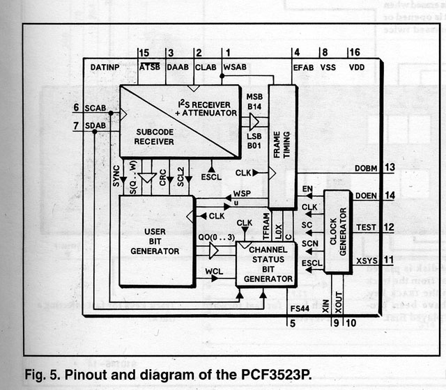

mdlover said:don't know if this diagram is useful? 🙂
Hi MDLover
This looks like you have a scan taken from a spec, do you have any more info from that same spec ?
Would love to receive a copy
all the best
Hi Guido,
The pic was scanned from an article on "Elektor Electronics" published 1992.
The article was about modifying an Philips CD player (adding SPDIF digital output). That's all I have about this chip. 🙁
Cheers
Cheers
mdlover said:Hi Guido,
Cheers
OK, clear enough
I even may have that article.....
