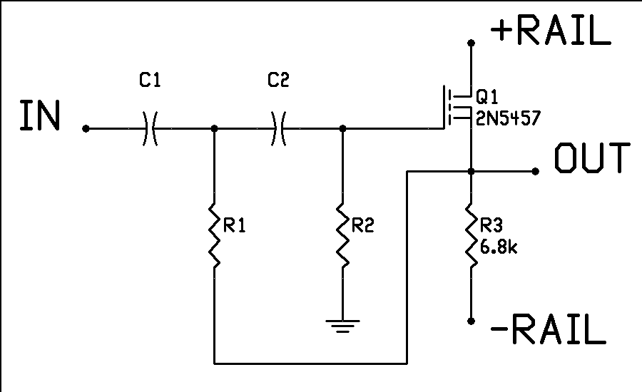

I've posted a schematic for the basic Sallen-Key high pass filter below. (Yes, I know the 2N5457 is a JFET but I'm using the symbol for a MOSFET--I haven't taught the program I'm using the symbol for a JFET yet.)
The formulas for the resistors and capacitors:
BUTTERWORTH
C1=C2 choose a value, to get started, try something in the 1000pF to 10000pF range
R1=0.7071/(2*PI*F*C)
R2=1.414/(2*PI*F*C)
BESSEL
C1=C2
R1=1.1017/(2*PI*F*C)
R2=1.4688/(2*PI*F*C)
Note that R3 doesn't really have anything to do with the crossover per se. It sets the bias current for the follower. I use +-15V rails, so this sets the current at about 2mA or so.
Device selection isn't that difficult. Essentially, you want a high input impedance and a low output impedance--which leads a lot of folks to want to use opamps. Go ahead, if that suits you. However, you don't need all that extra circuitry, as there's a ready-made circuit topology that meets the criteria--the follower. If you use a tube, JFET, or MOSFET, you'll have a very high Zin; somewhat less with bipolars, but still high enough that the crossover points will come out as predicted by the formulas. The Zout situation is reversed: bipolars are lowest, with tubes, JFETs, and MOSFETs coming in higher, but again low enough that the formulas will work just fine.
Incidentally, you'll need a DC blocking cap at the output.
Some people will want to know if you can substitute a current source for R3: Yes. Can you use P-channel or PNP devices: Yes. Can you use the DC blocking cap as part of the crossover: Yes. There's lots of latitude, here. Use your imagination. I'm just giving the bare bones. Don't be afraid to experiment. Your average small-signal transistor costs less than a dollar, frequently less than a dime. Fiddle with the circuit. Change things. Watch what happens with meters and oscilloscopes. Learn things. Enjoy yourself.
I'll be back later with the Sallen-Key low pass, then we'll tackle the other options as time permits.

Grey,
Looks like you could replace R3 with a current source, possibly another 2N5457 with a trimpot between the source and gate to adjust for offset.
Jam
P.S. Another 24 posts and you will be a DIYaudio Grandfather.
Jam,
Us grandpa-types tend to get senile...I thought I put in somewhere above that R3 could be replaced with a current source. If I didn't, well, I meant to, maybe that counts for something. Keep in mind that the gate is tied to ground via R2, so if you use a pot, you can adjust the bias, but I don't think you'll manage to achieve 0V DC offset at the output.

Grey,
Not being a spring chicken myself (46), I realize that I should have said that the current source could be modified to zero the offset.
The reason that this can be done is a j-fet is a depletion mode device. This is how you do it:
1) Remove R3 and attach a ,say, 47 ohm resistor to the source, the other end is the output.
2) At the output connect a drain of another 2N5457.
3) Connect the source and gate of the second fet with a 100 ohm trimpot.
4) Connect the gate of the second fet to the negative rail.
You can now adjust the offset with the trimpot. It helps if the fets are matched for IDSS, so you do not need an output coupling capacitor(good). This circuit works well in my experiments.

Jam,
Huh...forget the vodka, Geritol's got enough alcohol in it to strip the paint off a shrimp trawler. Tastes awful, though.
Now, the wine I had with dinner tonight--now, <i>that</i> was tasty.
Da, I see what you're saying about the 47 ohm resistor. That would work. But sneaky me, I make that DC coupling cap do double-duty, as I need the extra slope. Still, if all someone wanted was 12dB/oct, it should do the trick.

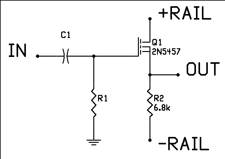

Time to put it in reverse and do the basic 6dB/oct. filter high pass section. There's only the one formula this time:
R1=1/(2*PI*F*C1)
although if it makes you happy, we can solve it for capacitance:
C1=1/(2*PI*F*R1)
At least that way, we make things look complicated by putting in more formulas.
The reason that there's only the one formula is that there's no Butterworth 6dB/oct. calculation. It's technically a Bessel, which is why people are always talking about how 6dB/oct. filters are better in the phase realm. It comes to them naturally.
By the way, you should memorize that formula, as there will be a quiz Friday. If I wake you from a sound sleep, you should be able to mumble that formula without hesitation. Why? Because it's just about as fundamental as Ohm's Law.
And AudioFreak gets this week's gold star, but if he doesn't stop passing notes to Susy, I may just take it away...
