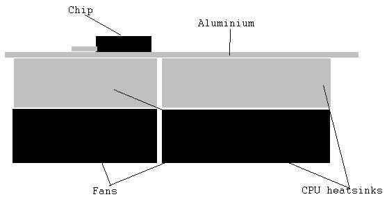

any links to the HD coolers? i was thinking of using one in my 6 channel car amp that i am building, as the chips (16 of them
) are mounted onto a piece of aluminium, not a heatsink, i thought that i could fix one to the underside. i chose instead, to cover it with old CPU heatsinks, and mount 4 PC fans (out of a huge PC (had 8 in the back, it was anchient)) under these. see diagram.
