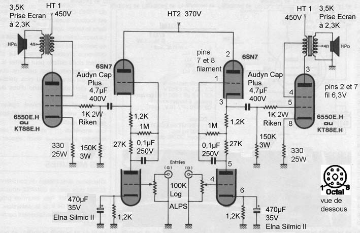

I've designed one myself, however I can't give any guarantees that it will work the way you wan't. I have successfully assembled one channel to try out and it works like a charm, the only "problem" is the low output power. But I'm beginnig to think that low power is something that almost all single-ended amps are limited by. Anyway... here is the schematics
http://213.67.45.70/se_kt88_3.gif
[edit]
About the cathode-resistor for the KT88. I've tried 470 and 330 ohm. Both with good result. It feels like it sounds best with 470, which makes the amp draw 75mA at 400V.

I like single-ended amps with a KT88 as driver. (allthough I haven't really tried anything else) I noticed some negative vibes when I mentioned SE-designs but never mind that. They're easy to build and sound great. The only problem is the output-power, but as long as you have fairly sensitive speakers that shouldn't cause any problems. :cheerful:

I have been working around one about three years . I use
TFK brand 12ax7 , and original GEC kt88 . In the signal path
lately im very impressed with the accuracy and tonal neutrality
of the Auricaps . In the power supply for smoothing i use 6x
50uf = 300uf with ASC metallized polyprops in oil , sold by Angela
after beeing two years using old oil caps that i take off from
an american war air force RADAR of the fifties . Tantalum resistors
are very good too .
Believe me this amp , well built, can shake your furniture with only
10W . It s y life`s amp , i have another pair of GEC kt88 .

Hello,
I am interested in building a KT88 single ended, and I want to use a schematic that some of you have already tried:
http://www.bonavolta.ch/hobby/en/audio/kt88_1.htm
That schematic was published at the L'Audiophile magazine in 1980. ¿Do you have more details about it, or do you know where to find that article?
¿Have someone tried the second schematic?:
http://www.bonavolta.ch/hobby/en/audio/kt88_2.htm
This one was published at the book "Build your own Audio Valve Amplifiers" by Rainer zur Linde. I have already ordered that book from amazon, so I will also study this second option when I receive the book. :scratch:
About the output transformer, ¿do you think the Hammond 1627SE is a good option? hammond
¿What Sowter model is the appropiate one?
