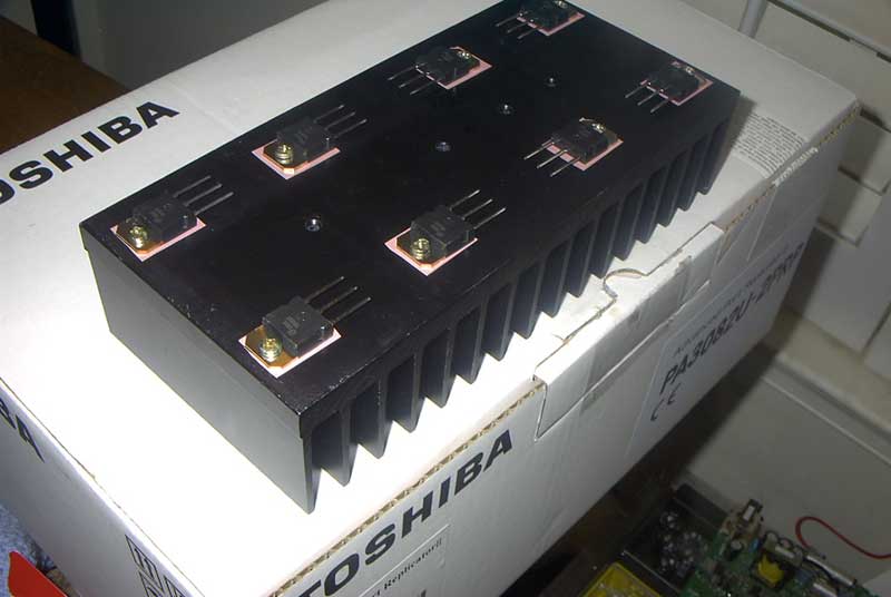

This is an output module, single channell, I'm building. These tip2955/3055 are pretty dated but cheap. I'm shooting for 200~250w's a channel into 4ohms. I'll post the complete, of course, when I'm done.
I think you will find you can get pretty good results with tip2955/3055 if you under-rate them, i.e., use more than you really need so as to keep them well within their SOA. I did a simulation using Onsemi models that seemed to indicate that if you used enough so that the worst case emmitter-collector current stayed below 2/3 to 1/2 the max rating, the noise and distortion figures would be in the same ball park as much newer and exotic devices. Since these are relatively small and cheap your approach could be quite sensible.
