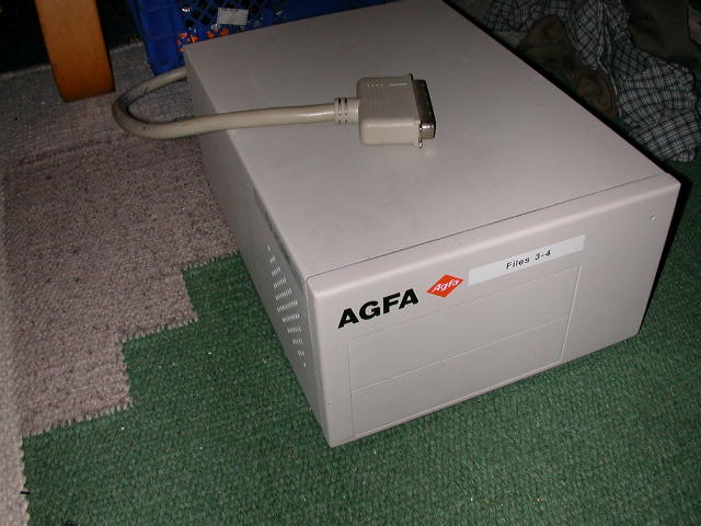

It had to be minimum cost, so I looked arround my tiny dorm room, to see what I got.
Inspired by the Sun GC, I lay my eyes on two old AGFA external SCSI discs. These things are large 4Gb discs from an old graphics system I believe. I pulled the SMPS, fan and the disc, a 5,25" by 8 cm tall monster.

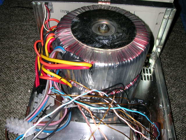

Next thing: Transformers. Not much to choose from, but I got a few 2x37V @ 1000VA toroids. Hmmm... too much voltage, then I'll just take and series two of them at the primarys and then parallel the secondarys. Tadaaa - a 2x18V @ 2000VA. 😎

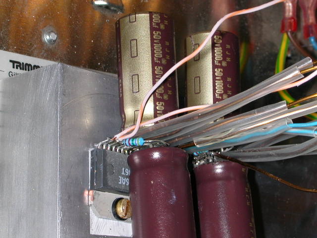

The GC is inverting and the most simple design I could find. Just the LM3886, two ELNA RJH 1000uF caps (had to buy these) and two resistors (1% metal film). Ofcouse, I need another resistor to bypass the mute function, so that's three resistors.
Close up at the toroids: You can see a lot of wireing here. I use stripped cat5 wire for all signal levels and 0,8mm transformer wire for supply and out. The heatsink to be fastened with L shaped aluminum and the wires will be shortened to look nice...
Picture of two channels finished. I have planed for 6 channels, guess the transformer can take the load. 🙂 The visible resistor is the mute resistor. The feedback resistor is hidden by the caps.
