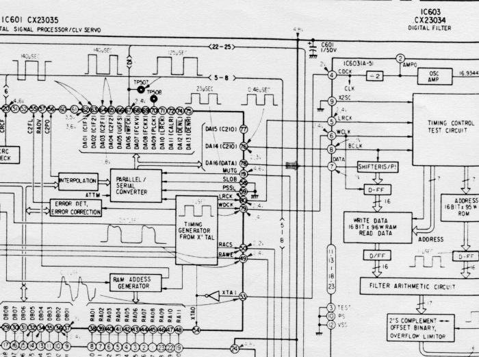

Here's the schematic of the DSP and digital filter section in my Sony CDP620 player. I'm trying to get I2S from DSP and connect it directly to TDA1543. I'm not sure if I used proper connection, as I got very week signal in left channel and noise in the right one. I made the following connections from filter pins (CX23034) to TDA1543:
pin 8 (BCLK) -----> pin 1
pin 7 (Data) -----> pin 3
pin 6 (WCLK) -----> pin 2 of TDA1543
plus I connected ground from Sony board to the TDA1543 chip.
Will it work?

Very probably the signals coming from the DSP are not Philips I2S format but Sony/Burr-Brown format.
You can convert the Sony format to I2S by the schematic published by Kal Rubinson in the Audio Amateur 1, 1997.

Hi Peter,
yes I did that in my old Sony as my first NON-OS experiment. Sound is too soft though as you are not using the two MSB bits . With the AD1865 actually you need some kind of zero stuffing scheme. Porobably also the reason Audionote is using the CS8414 in there CD-2 CDP. The 16 bit AD1851 gives normal output in the Sony but sounds worse than the AD1865.😎

Peter Daniel said:Here's the schematic of the DSP and digital filter section in my Sony CDP620 player. I'm trying to get I2S from DSP and connect it directly to TDA1543. I'm not sure if I used proper connection, as I got very week signal in left channel and noise in the right one. I made the following connections from filter pins (CX23034) to TDA1543:
Will it work?
No. You will not get I2S out of this DSP without a considerable amount of glue logic. The CX23034 is strictly a Sony format device and I mean Sony not Sony/BB.
For the input to the CX23034.
Pin5 = LRCK@44.1KHz
Pin6 = WCLK@88.2KHz
Pin7 = Serial Data (Two's Complement MSB first)
Pin8 = BCLK@48Fs (2.116800MHz)
You need the TDA1543A

That makes sense, as LRCK seemed to be needed in that application.
So using AD1865 is not that simple either with that format?

The TDA1543A is emphatically NOT offset binary in any way, shape or form . It is Two's comp with 48 SCLK cycles per L/R frame.

Hi ray,
Must Peter use LRCK or WCLK to connect to pin 2 (WS) of the TDA1543A ? What is the difference between the two versions of the TDA1543?😕
