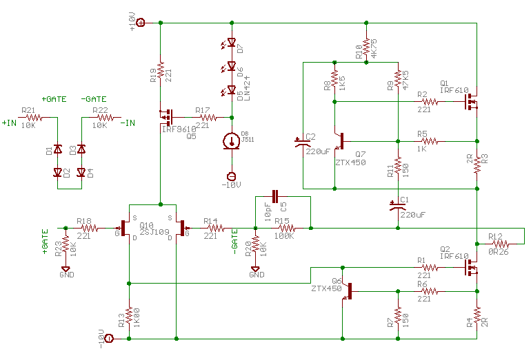

Just about the only way to improve on <a href="http://www.diyaudio.com/forums/showthread.php?s=&threadid=2451">tortello's beautiful Zen headphone amp</a> is to go for an Aleph headphone amp. The advantages are the balanced FET front-end and the DC-coupled output. This design is specified to put 500mW into Grado headphones, or other phones with about 32Ω impedance. It should also drive a small speaker, and indeed has done so in a breadboard incarnation.
Right now the only thing I'm not liking is the high value of the current sense resistor. I used it in my breadboard mockup but I might change it for something smaller.
One channel shown.

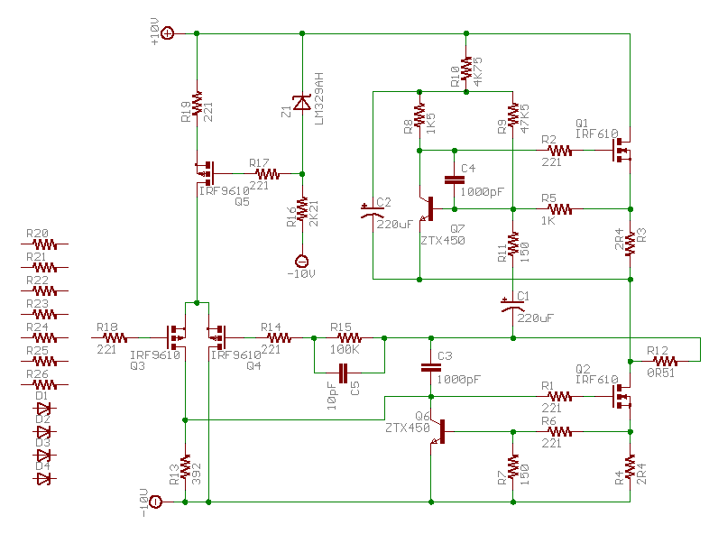

Take 2. The front-end doesn't have enough headroom with that 9.1V reference, so reduce to 5.7V via an LED string. Switch to 2sj109 monolithic FET pair. Increase idle current to about 220mA. DIscard C3 and C4.

I also increased the design rail voltage to 14V.

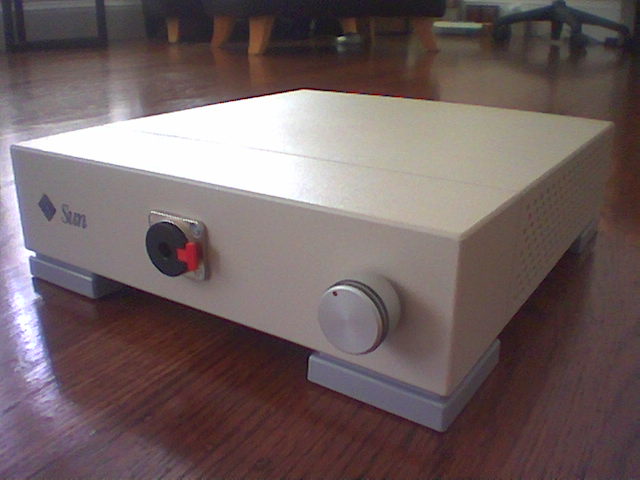

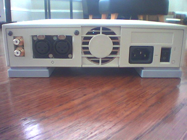

Case finished
These Sun 411 SCSI cases are awesome for audio projects. The SCSI connector cutout is just the right size for two Neutrik XLR jacks. And, the case comes fully shielded contains a switched, fused power entry module. What more could I ask for?

Hello ,
thanks for the compliment, but I've only turned the Pass' design into a smaller world.
In your design, the lack of a capacitor between R20 and the ground might bring about this problem, but if it works...
