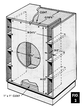

I would say the Onken enclosure probably qualifies as an enclosure with external ports.
Interesting thought. The Onken is by the Jensen company. A fellow named Novak was an engineer at Jensen. In the mid-fifties, Novak published a paper essentially outlining the correct way to build a bass reflex speaker. It was not as detailed as the Thiele and Small papers, but it gave the reader pretty much everything he needs to build a proper bass reflex. In other words, Novak's paper was a like a summary of Thiele and Small's later work, only he published it years before they published their papers!
Before Novak, everyone was pretty much shooting in the dark about the bass reflex design. Thiele and Small had much greater effect in the popularizing of the ported design, but Novak laid out what you needed to know.
Well, the Jensen company claims that the Onken design gives superior performance to a normal bass reflex. I don't know when the Onken design was created, but if the same company which essentially figured out the bass reflex design claims an advantage for the Onken over the normal bass reflex, it does give some credence to the idea that the Onken is something special. I guess it depends on when the Onken was created-before or after their engineer, Novak, figured out the bass reflex design.

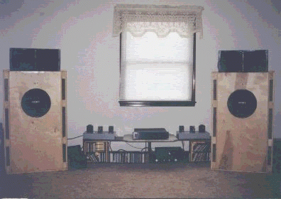

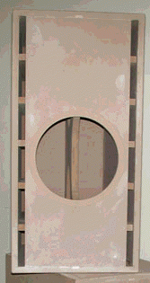

Roscoe Primrose seems to have some rather nice Onkens.
http://www.aiko.com/roscoe/diy_first.html
If you are looking to build these, it seems to me that you can modify the design of the Onkens ever-so-slightly to emphasize the separateness of the ports. Would make construction somewhat more complex, though. Hard to imagine that it would affect anything sound-wise.
Thanks.
These are very interesting, kelticwizard. The slotted ports appear to predict the current line-up of Genelec studio monitors. Maybe there is a common thread between the two.
Also, if you were to flatten out the internal surface area, the result would resemble a very short transmission line. The overall "taper" seems to be similar as the ports area is quite a bit larger than your modern tube port.
There is no indication what kind of driver was ideal for the various sizes of enclosure and port. I am guessing that all this was before Thiele and Small so the measurements must have been a generalization for various drivers available in that age.

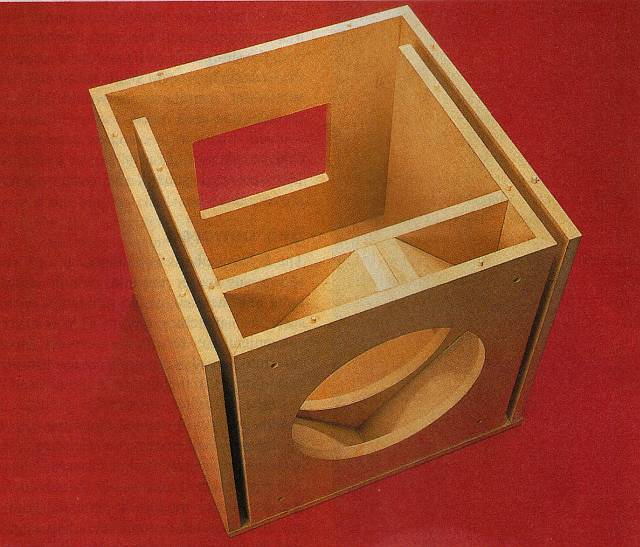

Jaycar in Australia have a kit for an Isobaric one.
http://www2.jaycar.com.au/productVi...xxx&pageNumber=&priceMin=&priceMax=&SUBCATID=
Pic of box from original magazine article.
