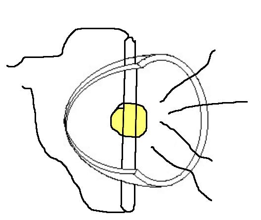

I've been noticing for a while now that commercial lcd projector lamps look something like what is below ( If anyone could confirm this that would be great because i haven't looked at one personally just pictures on the web) ...It's quite different than what us DIYers have been doing (i personally haven't done anything yet)....I think the actual bulb is placed lengthwise in the reflector with a wire attached to end that sticks out instead of that end being inserted into a holder. I guess this is so less light comes directly from the bulb and most or all of the light comes bounced off the reflector and, i guess, parallel.
So I was wondering since the commercial lamp makers do it like this (pretty much all of them) then why aren't we trying a similar design, since it seems to be optimal...Obviously ALL the design is in the reflector which i guess is mathematically designed to reflect the light optimally (and filter out UV).
Any thoughts?

Ok, but what i'm saying is that from looking at all these newer commercial lamp assemblies, it seems like none of them use light that eminates directly from the bulb itself. I say this because the "end" of the bulb is what points out from the assembly and there is a wire attached to this end (the end that sticks out toward the direction the light is traveling in --- see my pic again...i include it again below).
It seems that these lamps use ONLY light that is reflected off the reflector....and don't use any light directly from the bulb. This means that the design of the reflector is very precise and mathematically derived to yield a light beam suited to the projector. And since all these "newer" lamp assemblies that i'm talking about basically use the same design (pic below), i gather that these reflector designs are mathematically designed to optimally reflect as much of the bulb light as possible into a more or less spotlight type "straight" beam.
So what i'm thinking is since so much money and thought has been put into the design and shape of these reflectors, then maybe THAT is the best configuration for projector lamp design....
So what i'm saying is that maybe we could stick a HQI into a copy of one of these reflectors, in the same position as the usual bulb would have been placed (or maybe we can find a commercial bulb/reflector assembly where the bulb is pretty similar to a HQI--not exactly similar but maybe we can find a best match), And stick the HQI in like i'm saying; instead of holding the HQI in a double ended assembly, we could attach a wire to one end and stick it in lenghtwise like the commercial lamps are doing.

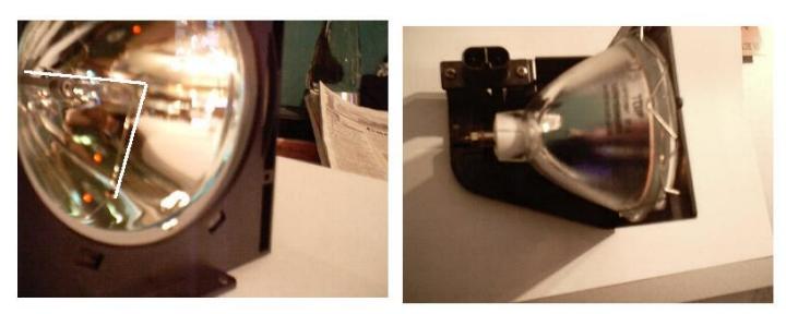

FREAK, could you maybe take a picture of the commercial lamp you have?

Ok property I see what your saying now. I attached a pic with 2 diff views and the white lines show the bulb position and the wire position. However I can confirm that the light emitting portion isnt at the end of the bulb (like in your pic) its twards the middle( HQI like) and this new thought on lights is highly interesting because it means that the light is emitted to the side of the lamp not directly forward( well it does go forward but only via the reflector) hope that helps some more or ignites more thoughts.
Yeah that is what i'm finding interesting...The light is not emitted forward from the bulb but comes, all of it, bounced off the reflector.
Yea I wish I could say I had a almost dead bulb But the pic is of a brand new bulb and My current bulb has like 1600 hrs still on it. However that said, Even if we are able to make a mold, how Smooth would the surface be? and what kind of paint would we use to make the reflector? this thing is madddddddddd reflective.

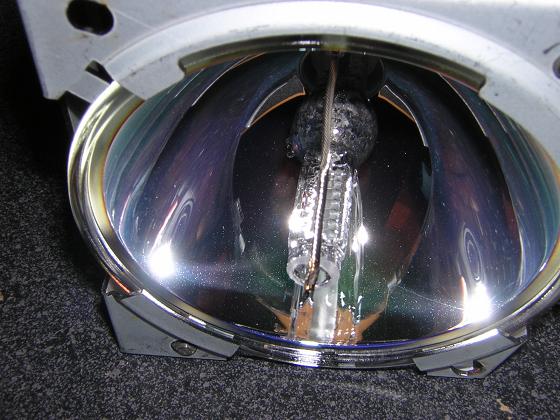

I have open up my lp720 before just for the heck of it to see the optic system. I think you are right videofreak those lamps or reflectors I think were engineer to gather all of the light and send it right into a mini fresnel lens about 3 inches square, there are a couple of them I recall. So unless you are using a condenser lens or something else to spread the light out for a bigger fresnel for your lcd panel you will see a very bright spot right in the middle of the lcd. This way might be more efficient since you are using all the light from the bulb.
The lamp in the picture was from a 3m projector. As you can see it is not enclosed, I think some are enclosed is just for safety incase it blew up. It sticks out about 1/2 inch. So I think if you can retro fit anything in there the reflector will do the job.
Some ideas....
