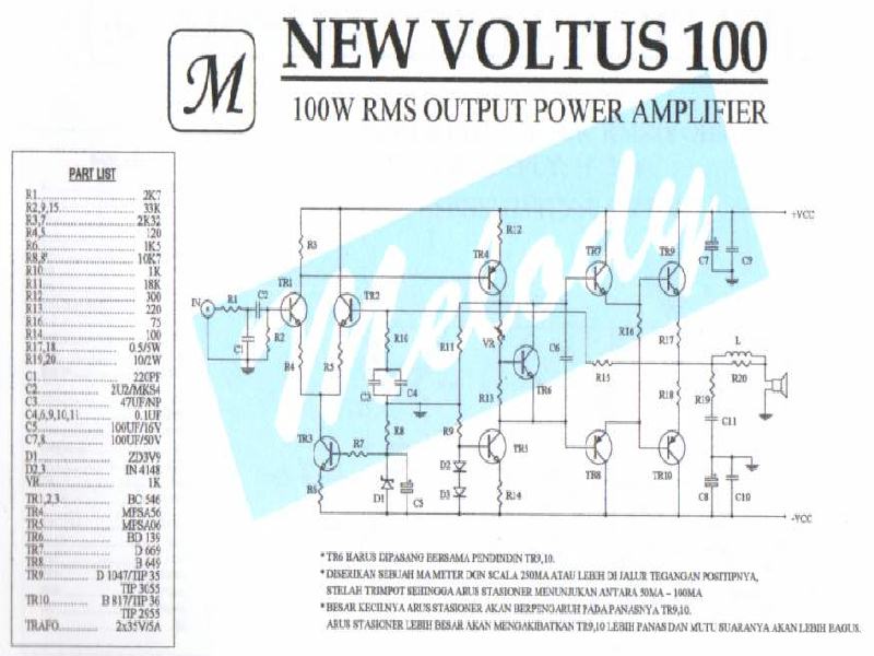

Hello,
After many try-outs of my previous project (and after a blown speaker and several transistors) I've decided to start something new. I've build a good and stable power supply which consists of 8 transformers (230v => 1 x 35v , 4A) and 6 capacitors (6 x 37000 µF). I also want to thank all the people who helped me with my previous project, but I can't solve all the problems (the problem of oscillation is solved, but now a DC-current appears at the output).
So I started to search some amplifier designs which match to my power supply (2 x 50V/16A). If this amp (http://members.tripod.com/valveaudio/images/schematics/voltus100.JPG) works well, I want to build four of them, so I can bridge (2x) two amps together to make a amplifier of 2 x 400W (also see http://members.tripod.com/valveaudio/images/schematics/bigvoltus1.JPG).
What do you think of the included schematic?

Palesha is right. For sure with just one pair tip3055/2955 you will have problems with this amp, if you use it at continuous high power levels. With TIP35/36 I think it can work, but the output transistors will suffer. Two pairs per channel will do the job very well.
regards
It must be pointed out that both the TIP 3055/2955 and the 35/36 pairs have a safe area that folds back above 30V, in reality they can only handle 50W at 50V and that is at room temperature. With typical heatsinking and mounting I would say 10W per device. This means that a pair would be adequate for a 50W class AB amplifier. While the 35/36 are available in the 'C' or 100V range the 100V rating on the 3055/2955 is only when reversed biased. When forward biased in a class AB amplifier they must be resricted to +/- 30V. NAD tried to use these with +/-40V in several designs. When they blew up I replaced them with MJ15015/15016, which are 3055/2955 die family that have been selected for high voltage. TR4/5 are listed as MPS A06/A56, they can only take +/-40V, in case you haven't figure it out yet this design is a waste of time and money. On the other hand http://valveaudio.tripod.com/images/schematics/400w.jpg with MJE15030/15031 for drivers will do what you want with two pair of outputs per bridge half. This is exactly the same tripple darlington output stage as in a Crown Macrotech 1200, they use the MJE15030/15031 as drivers and MJ15003/15004 as outputs. If you see beefing up the supply someday and driving 2 ohms, build it as shown with four pair of outputs per bridge half.
Hugo,
This design is better than your previous project, but, again, the safety margin is too low. Tou have to consider all given advices, and use quality transistors for the output stage, in suffiscient quantity, otherwise you will burn transistors and speakers again and again.
Generaly speaking, 3055 or similar devices exhibit poor gain and linearity, and have to be used only for public adress, not for high-fidelity purposes.
TIP 35/36 C are usable, but with at least 3 pairs in the output stage, in order to maintain collector current in safe limits if the amplifier is overloaded. Each transistor must have its own resistor in the emitter connection, as usual.
MJE 15030/31 are the good choice for the drivers. Don't use another devices, these are specially designed for hi-fi driver purpose, and work very well.
Ragards, P.Lacombe
ONE pair of MJ15003/15004 have MORE safe area than FOUR pair TIP35/36 at 50V at elevated temperatures. This is entirely because of the plastic cases on the TIP parts. Yes, you can make an amp that will work with plastic outputs. But for how long? And how much is it going to cost to replace those woofers and crossover parts when the amp 'grenades' a couple of years down the road? A relay you say? Don't make me laugh! Relay contacts will arc and then weld when trying to open DC into an inductive load. Add a 'crowbar' circuit with a triac if you are going to use plastic.

I didn't checked out the safety-margin of the outputdevice, but I learned I will check that first before even thinking about building a new project. It's amazing how many published designs have too small safety margins. I think MJ15003/15004 (250W) is the best pair to use in this amp.
Thank you all !!!
