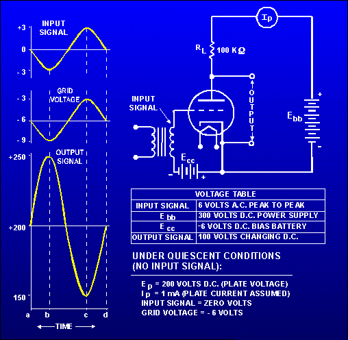

I've got some 6dj8 tubes in a common-cathode configuration with a cap bypassed cathode resistor. I'd like to try battery biasing, but what would be the optimal voltage of the battery used? Also, if I use a battery with whatever voltage you guys sugest, what anode resistor should I use with a 180V B+? Thanks, but I'm still a little unsure when it comes to tubes, but I'm progressing...
2.5V to 3V is generally a nice voltage. A 3V lithium is actually closer to 3.6V. A charging pair of > 80mA/hr NiMH in series in the cathode will give about 3V. Alternatively, you could use grid bias with a pair of AA alkaline batteries in series with your grid leak resistor. Try 18k as your anode load, and it should draw about 4mA with 3V bias.

Want to explain to me the AA grid bias? As I said, I'm a noobe to tubes... Also, what would I go about doing if I were to change the B+? I'd only change the anode resistor with proportion to the change in B+, right? Ah, so many questions...

you need a set of anode characteristics for your valve. This is a set of graphs that shows anode current against anode voltage for differing values of grid-cathode bias. An excellent source for these is:
http://home.planet.nl/~frank.philipse/frank/frank.html
Once you have these curves, you choose your HT or B+ voltage, and mark this on the voltage axis. Then, having chosen the resistance of your anode load, you divide this into the HT voltage to find the maximum current that could flow, and mark this current on the current axis. You now draw a straight line between your two marked points. This is your loadline, and shows how the anode voltage can vary with your chosen HT voltage and anode load. The operating point along this loadline is determined by the grid-cathode bias voltage you choose. This is necessarily rather abbreviated, but there are lots of currently available books that go into more detail - have a look at the component distributors.

If you add a potential divider, the cathode will develop a feedback voltage across its output resistance. With battery bias, you have to accept the battery voltage and change your circuit to suit.
EC8010 what you mean by
you mean that the resistance of the pot would be the cathode resistor and thus bias the tube?
An unbypassed cathode resistor develops a feedback voltage, so we short-circuit it with a capacitor. A battery is already a short-circuit, so it prevents feedback. Adding a potential divider brings you back towards resistor bias. You have to use your battery and change the rest of the circuit to suit.
