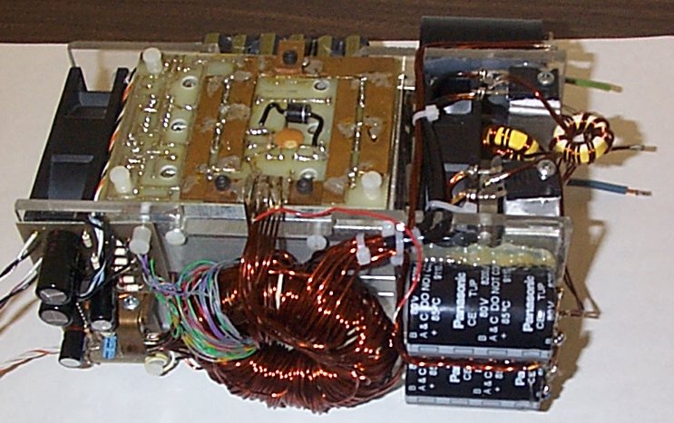

P.S. There's a pic of a 2Kw DIY switcher.
note the liberal use of hot-melt adhesive!
do well all use Hot-Melt for keeping caps in their place -- I do too!

2kW Switcher
Hey dkemppai,
what controller chip did you ise? Toroid core? Switching frequency? output voltage(s)? (I like that big honkin' toroid!)

LM3524D, +-65 VDC regulated outputs. Switching frequency About 45 Khz. Input caps are paralleled 3300uF FC series Panasonics, output are snap-cap type 8200uF 80 Volt TUP Pans also. Switching Fets are IRF1010N's with several in parallel.
The big toroid was a find. P Type Magnetics, I can get the exact part number later. I managed to get my hands on 18 of them in the last few years... ...normally not cheap (Ebay is great!) WaAc is massive. Second largest toroid they make.
At 1500 Everything runs ICE cold. No heat at all. If I were to do it again (and I probably will), I'd downsize a bunch of the components. It was my first attempt at a large PS, and I'll do a bunch of things differently the next time.
-Dan

2 kW
Dan,
No way, dude! Keep it cool! 😎 Since you're not putting it into mass-production, don't worry too much about down-sizing. Probably put it on a PC board with seriously beefed-up traces where appropriate, but don't downsize the MOSFETs. Those 100A FETs are just the ticket! Too bad ON doesn't make them anymore!
