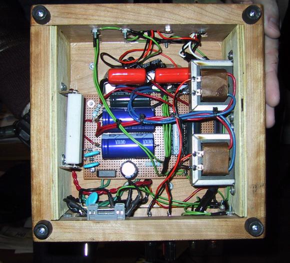

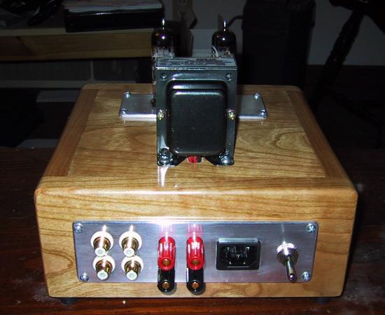

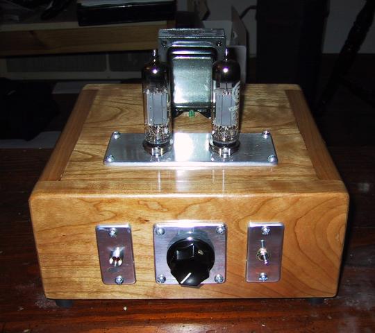

Hi everyone;
Sorry about the delay, but I finally got the pics in of the 6BM8 SET that I've been working on. These are actually pics of the Mk I version prior to it's first extended use trials that showed up the heating problems inherent with the 269JX in this application. The current Mk II not only uses the 270DX trafo (which still runs warmer than I would like, darn it...), but the chassis has some small but important changes, like a 3.2cm x 3.2cm vent on the sidewall nearest the dropper resistor and a vented aluminium bottom plate that is designed to also work as a heat sink for the dropper resistor. Other changes include bypass caps fitted to all electrolytics in the amp.
I'm christening this little one "The Gnat".

Congrats! Looks good. A nice neat layout.
I really like the sound of mine, its great. Perfect for low volume listening. BTW NOS ECL82s are pretty easy to come by as well, you should try and pick some up. I also have read good things about the svetlanas.
What circuit did you use for that? And are those output trannies out of an Akai or something?
Thanks everyone! As usual I spent far too long worrying over the cosmetics of the chassis, so it's good to know that someone else likes the looks!! :)
One comment about the box design for anyone else who's thinking of trying it is that (for the first time!!) I had some shrinkage in the cherry that's the top plate. It's 2 pieces of 3-1/2" wide, 3/4" thick cherry that I edge glued with a biscuit between, and there is now a 1mm wide gap between the 2 planks (*grrr!!*) that I've had to fill. If I had it to do over again I'd have laminated a 1/4" thick piece of plywood to the underside of that top deck for stability - and I'd have oven dried it first, myself, to make sure it'd done it's shrinking prior to assembly. Oh well, live and learn....

The circuit and all the current data for this version can be found in a couple of posts at: http://www.diyaudio.com/forums/showthread.php?s=&threadid=14694&pagenumber=3 Thanks again Dave, for all your help with posting the schematics!! :)
Actually, all I can say for sure about the OPT's is that they are 5Kr->8r and that they're "...OEM surplus made by Ravenswood Electronics, 1972 date code..." Maybe from a colour TV or a small hifi? It was the tail end of US electronics manufacture, so there was more than a little nostalgia for me in buying 'em.

The sound on the Gnat has been good from the start. However there have been small issues that I've had to resolve, as well as tweaks (one of which is still in the offing) that have improved the amp markedly.
In general the sound is somewhat 'vintage'; it's great with everyone from Sinatra to Louis Armstrong, and very good at moderate volumes with everything from Beethoven's 6th to Sarah McLachlan. The biggest audible weakness is in the bass - those OPT's are just plain tiny, so don't expect Wagner's more sturm und drang filled pieces to really rattle the neighbour's windows! Running it through my FE 164's and comparing it to my 10x as expensive 2A3 was very enlightening. For one thing, this is one QUIET amp - no hum that I can hear unless I switch to 95dB efficient speakers and place my ear right up to the driver. Overall I'd say the 2A3 has a little better definition on complex orchestral passages as well as decidedly better bass slam. BUT it's not 10x better. And in some ways that little Gnat outshines my 2A3, particularly in saxophone passages (I used to play alto, tenor, and baritone sax, so I know what a sax should sound like - the Gnat's got the edge there no question). IMHO most of the sonic advantages of my 2A3 comes down to the OPT's - $9 per OPT vs $100+ per OPT - go figure.
The main issues during the development of the Gnat were related to heating - the 269JX was running at red faced maximum (and actually was over the manufacturer's spec for the HT winding) and it showed it with temperatures that were higher than I like. The 270DX does about 9 degrees C better this way and is being run within manufacturer's spec on all windings - and well under the overall VA rating; sonically the change in trafos was a bit better handling of dynamic material. Biggest disadvantage I've got going now is the amount of heat dissipated with that 1k5r dropper (used to bring the operating point down to the original one used with the 269JX). If you use this approach, I'd recommend going to a heat sinkable aluminium sheathed wirewound so that you can dump that heat efficiently into the bottom plate. For now, the MK II variant uses a aluminium 'heat shield' that partially wraps around the ceramic dropper (at a distance of about 4mm) which is heat sinked into the bottom plate. This helps a lot, along with the large 3.2cm x 3.2cm vent on the sidewall nearest the dropper resistor (it's covered with a hand made .32cm thick aluminium grille).
If you opt for a wooden chassis, I'd strongly advise that you both check that the wood has done all it's shrinking ahead of time (i.e. it's COMPLETELY dry) and that you laminate a .635cm thick sheet of plywood to the underside of the top deck for additional stability. Also, if possible, you should use a plate joiner to make sure that all the joints are strong.
One option that I'm considering is the use of a 10H choke and reconfiguring the PS to a choke load. So long as I can keep my B+ within a couple volts of it's present value it would have the advantage of keeping the trafo even cooler and not having the excess heat to dissipate under the chassis. That would be a MK III variant though, and I'm not sure it's worth the extra effort and expense.
