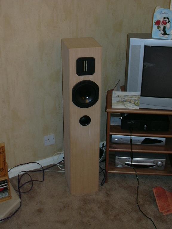

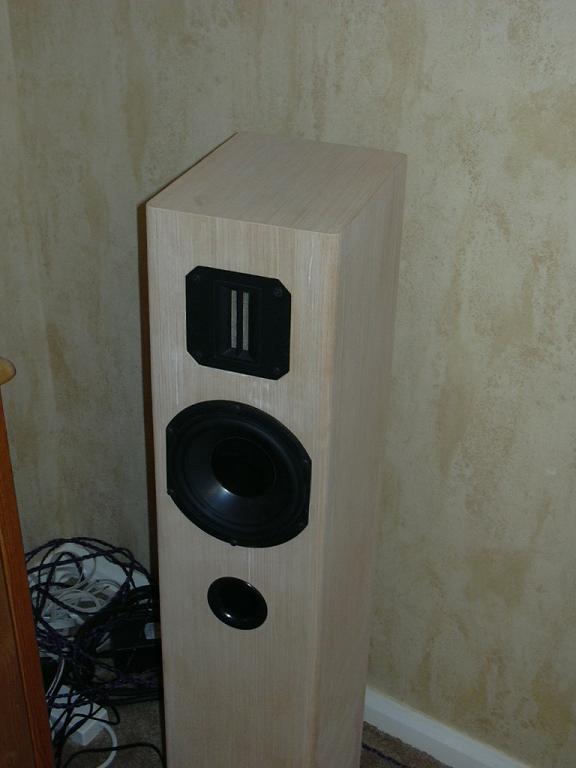

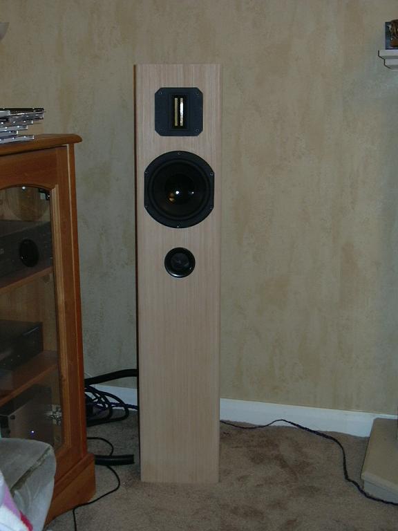

Here are some pics of my nearly completed speakers. All that is left to do is the laquering and plinths / spike (almost done).
The sound is simply superb...I have been playing with the placement of them for the past two hours and now have them perfectly "imaged". My method is to play a well recorded Quartet track and place them until I can pin point each player, and they are at the correct distances from each other. I have played in many quartets so I believe myself to be a good judge of this method. It took tiny movements but the image just "clicked" into place. The sweet spot is not huge but since I always sit in the same place, it's not a problem. It does not seem sensetive to general movement as I hear some can be. At first, when listening to a track of orchestra, I found the "edges" to be cut off. It was as though the front was not wide enough in it's stage (the violins and cellos). This has cleared up by moving them around a bit.
The speaker is ported (as you can see) and are made from a Visaton MHT12 and Peerless 164 HDS (w/o phase plug). The edges are routed and the lot is MDF covered in an oak veneer...
I really pleased with them!
Hope you like them as much as me!!!

How does the MHT12 perform? I have a pair of them but didn't mange to buid speakers around them 😀 But that's a problem I have with a load of other drivers as well. Seems, that I need a time machine...or a 30 hour day.
The internal wire is 5 strands of 19x0.15mm PTFE silver plated copper. The xovers are both 1st order crossed over 2700Hz. It also has attenuation for the tweeter.

Tell us more about the XO. You must have used a zobel, correct?
I am not sure if you are using on, but a trap for that peak at 4Khz might help a bunch.
How much BSC did you use? It looks like they are about ~1.5 ft from the walls (the drivers) I am not sure what sounds right at this distance, maybe 2dB of BSC?
Let us know the details of the XO, it is the most important and most interesting part of the speaker!! And I am curious as to how you worked it out with this one!

I have played them for about 3 hours now and although the bass was fairly weak to begin with, it is seriously improving. It is 80% filled with long haired wool. It is a 28.1l box, with the port tuned to 40.8Hz. This gives a theoretical -3dB point of 56.9Hz which is great for me...I can put in a REL Strata II clone to fill in the bass (When I build it).
The crossover is as simple as I could manage. There is no BSC although I may add this later, neither have I added a zobel. The latter was on the advice of the shop where I bought the drivers. I trust them implicitly. Again, I may try adding these later. First, I have to get used to the sound so I can actually hear the difference.

I would most definitely add a zobel network to your woofer. Due to the rising impedence of the woofer, your first order crossover is probably having very little electrical effect on the driver. It does have a pretty natural roll-off, especially off axis, which is nice. but for closer to on-axis listening, that peak will really mess with your upper treble.

Is your XO just a cap+2 resistors and an inductor?
If those are the only speakers you have, why not biamp them?

What about vertical dispersion?
Hello,
Nice work. Can you comment on the vertical dispersion of the tweeter? Can you stand up without losing too much?

You're correct Bricolo, that's all that makes up the xovers.
Salas:
You don't seem to lose too much but then I've not tried playing musical chairs with them! 😉 They seem good though...
