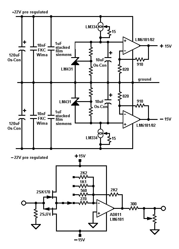

PS, attached a rendering of an experimental linestage from a few years ago, drawn by Carlos M. from a description by me, no guarantee for accuracy, I never drew a schema of this, all this is from memory and my memory is notoriously bad.
I think I had a 1k resistor (maybe 10k?) between reference Voltage and Op-Amp input for the reg.
It used LM317/337 Pre-regulators with very low resistance voltage set resistors and around 20V output, 10R - 1W & 150R or 180R - 5W. Sounded jolly decent, but I drifted over to Valves about that time, better sound.

Thanks for the info. I was looking at the AD8019 as the reg, which has very good PSRR and a low Zout (10mOhm I think) up to 100kHz or so. It can also source/sink a couple of 100 mAs (it's a DSL line driver really). And you are right of course on the emitter follower as worsening the stability margins. But you need it to get enough current. Since this opamp has enough current capacity, I'll like to try it without the follower.
So I should be able to run that without any additional local bypass cap on the load opamp. I can lower the bandwidth of the load opamp if necessary.
I'm not sure I agree on the cap issue. A good cap makes life easier for the reg, especially at the higher freqs. The LC filter you discuss would make it easier for the reg, but worse for the load.
Maybe the best way is to use a good quality cap with a value as low as possible for stability, say 10 or 100nF film. What is your experience with that?
The idea of low-value voltage set resistors is a good one to bias the prereg, I will use that also. It may also be a good idea for the opamp regs, to bias them in class A, although the static load (about 50mA) might already be enough.

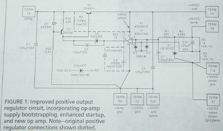

However, this must be ofset against the fairly marginally stability (even without the AD797 that thing likes to oscillate).
Again I have to take issue with this, using an AD825 as the error amplifier, there's no marginal stability involved with my implementations of the circuit. Yes it can be made to oscillate, but the conditions for oscillation are easily definable and easy to deal with.

The Jung regulator has remote sense lines available to take the feedback for the regulator at the load. The trace impedance is part of the open loop output impedance and is reduced by the feedback to about the same levels. The open loop output impedance of the regulator is a few ohms and you are adding a few 10s of milliohms to that before the loop feedback.
I have tried about a dozen of some of the more popular AD and Burr Brown Op Amps in a very similar circuit who no stability problems. Even the AD 797 is rock stable in mine.
I will not argue that capacitors have big influence on the sound of regulators but aren't the whole story. The Jung op amp based regulator has orders of magnitude better PSSR, noise, and output impedance than a three terminal at audio frequencies where the regulator is doing the most work. Large caps will not fix all these issues. There are also other approaches like discreet transistor circuits where one can trade off lowest output impedance for a flat output impedance across the audio band. For really good performance a three terminal regulator has too many compromises in performance for many people. you can get away with there use in digital circuits but the type and brand is audible there as well.
AWL has done a very nice implementation of this regulator and a SNAPS regulator upgrade with the best written manuals
I have seen in a long time. The manuals by themselves are a works of art that fill me with jealousy. Very nice job Andy!
http://www.alw.audio.dsl.pipex.com/products.htm
