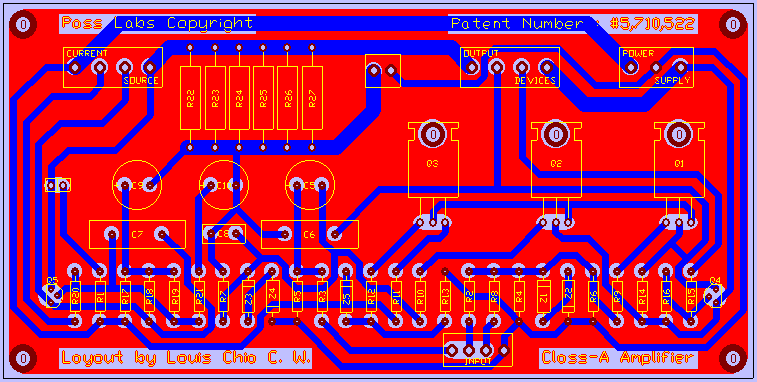

Hi diyers!
ya tis is e Aleph2 layout tat i did wif TraxMaker. Anyone using tis software? Im still figuring how to create a gerber for soldermask...😕 It was a hard decision to choose between Aleph2 layout or Aleph4 cos Aleph4 layout can be used for Aleph4, Aleph1.2, Aleph5, etc. Anyway itz an easy job to author it b4 fabricate. I've attached a pic of my Aleph2. Comments on e layout?
Yellow is e silkscreen, red is top layer (ground) n blue is e actual layout (bottom layer). Notice e thin traces for ground on bottom layer(blue)? Itz taken care of by e top layer(red). Board size is 6"x3". Actually i planned to send my gerbers to www.4pcb.com to get it prototyped for free as they r having tis "free protos for 1st timers". But after contacting them, i was told tat tis promo is open for US only...
Is there anyone in states who is interested to beta my layout willing to contact them n check about tis promo?🙄 Or any suggestions to get it done in Asia. Or anywhere else as long itz cheap including S&H to Singapore. 😉
Saw e row of resistors? Inspired by Kristijan's layout at web.vip.hr/pcb-design.vip/ Thkz to kristijan-k.🙂

Comments?
DIY enthusiasts,
comments on my layout? Any mistakes or ideas for a better design?🙄
Brian,
I was going thru ur layout n found tat C9 is connected differently. Y is tat so? Or mine is wrong?
Should I do tat too to make it more generic?

DIY enthusiasts,
Brian,

comment on PCB layout
I would try to avoid running power supply and any other lines parallel as much as possible. The way you have done it looks nice and tidy on screen but might not be the best from performance point of view. Might even cause unwanted oscillations.....
