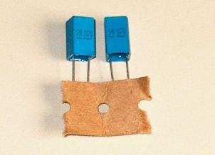

The stacked ones were good, I recall two versions. One with silver sleeve colour and one with green sleeve. IIRC the green was MKC. They suffered quickly from damage when heated too much. You could easily change capacitance by cutting off a thin sheet. They are obsolete for a long time now ( 10 years ? ).
I was referring to these Siemens/Epcos stacked caps, they are available in 2.2 uF and 3.3 uF at 5 mm pitch which makes them suitable as replacement for electrolytics in some ( but not all ) cases. Datasheets can be found here: http://www.epcos.com/inf/20/20/db/fc_01/00150040.pdf
I believe you are correct. The green ones where my favuourites when modding SS Gear. Wherever I was uncofortable replacing an 'elcap that blocked no DC (normally) I'd drop one of these chipcaps in instead, cheap, good, effective.
They look real nice too.
