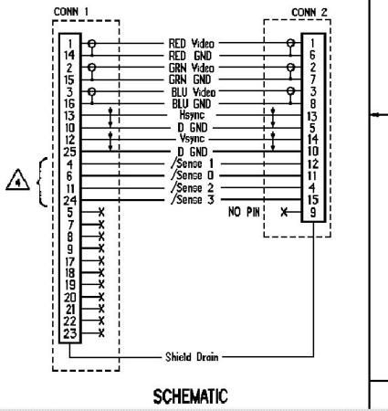

Does anyone have a wiring diagram for a 3M 5300 Vga to panel lead.
it has a standard vga at one end and a 15pin port that looks like a printer can anyone help
