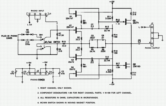

BTW...
Have anyone tried this? comments?
I think it is from a Hafler Pre-Amp....

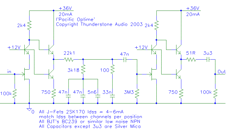

Konnichiwa,
Onvinyl said:
Thorsten's suggestions seem to be inspired of klaus boening's design, I think...
I think not.
We added cascoding Transistors to the Pacific long before Mr. Boening published his design.... I have liked using Cascodes in Solid State Circuits for a long time as they allow to combine devices to achieve normally conflicting performance items.
The simplest way to add the cascoding is to use good (Low Noise High Ft, High Beta, good Beta Linearity) NPN Transistors like BC239 and use a stack of 3pcs 12V Batteries for the Supply. The BJT's are added between FET Drain and Drain resistor with the Emitter to the Drain and the Collector to the Drain resistor.
Simply connect the Base of the Transistor(s) to the top of the first Battery (+12V) and apply +36V (nominal - in reality over 40V) to the +B Line. Worked a treat for us. BTW, the Drain Resistor should drop around 12V and the 2SK170 MUST be selected for identical currents for the two channels plus should have Idss of 4 - 6mA....
If one wants to implement Jocko's suggestion to place buffers simply add another BC239 Transistor with another BC239 as CCS. The Base of the first BJT goes to the signal takeoff Point, Collector to +B and the signal is taken of the Emitter. The RIAA needs re-calculating then.
I have done this and attached what I would suggest in this case.... Not as simple as before, but still a minimal number of components per gainstage (6components) and all the transistors can be glued together and hardwired so that hardwiring the circuit in air is still a perfect possibility. And each such gainblock offers a very low noise level with a gain of around 36db and pretty decent (thanks to cascode) linearity.
Another Idea, the schematic as posted here would be usable with the S&B 600R RIAA Module.
Simply connect a 600R resistor between the output of the first stage and the RIAA Module Input and remove all the other RIAA components. As the RIAA is input terminated the RC combo coupling to the next stage can remain just as shown....
